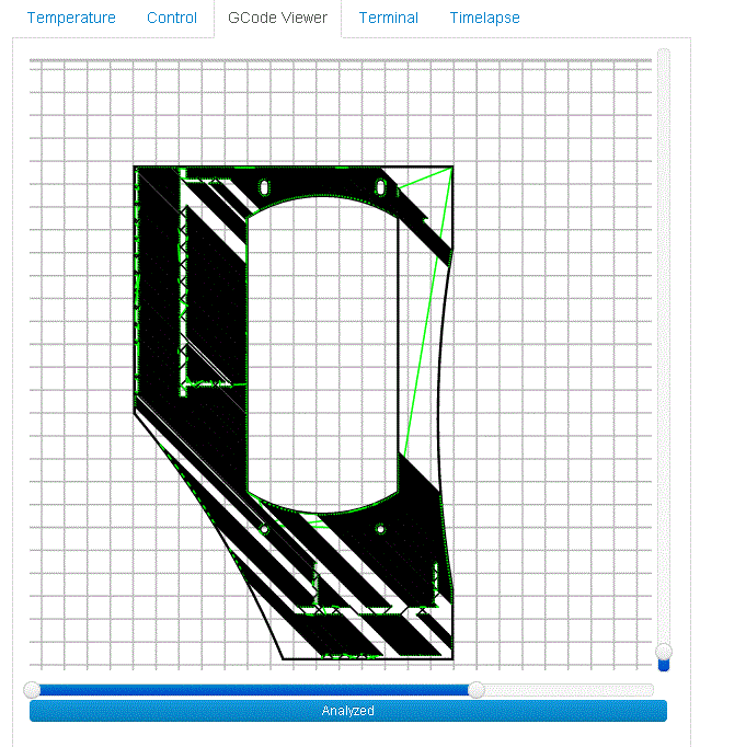

Has anyone else notice or is it me observing that Cura has a very inefficient gcode path process.
As you see on the attached picture in the white areas the gcode passes overs these areas meaning it doesn’t lay down plastic. Yes eventually it does come back and lays down plastic in these areas, but it just seem to me so inefficient.
When cura compiles the gcode what is MOST important ?. The most efficient travel path or quality or both.

Slicers have always done this type of weird jumping around. Slic3r is particularly bad in this regard. It was a much bigger problem in the days when retraction didn’t work well and the nozzle would be oozing every time it moved around.

I would think there would be a great advantage in speed if this was ever resolved.
Kinda happens when i use my ShapeOko 2 , so I use https://github.com/alsliahona/gcode-optimizer and it makes the path MUSH more effeicent

Cura is better than Slic3r last time I compared them. Cura attempts to have as few travel moves as possible, and it will do travel moves over old perimeters instead of crossing perimeters to avoid accumulating ooze. There’s a very smart commercial slicer out now (Simplify3D) that seems to be much smarter than the current free offerings, but I haven’t tried it yet.

I’d be excited if slicers do better path routing. That said, I don’t think there’s that much time spent “hopping” between different segments. Those hops are rapids and actual part build takes the strong majority of the build time. But if it makes the part a few percent quicker because of better sorted motions, I’ll take it.
