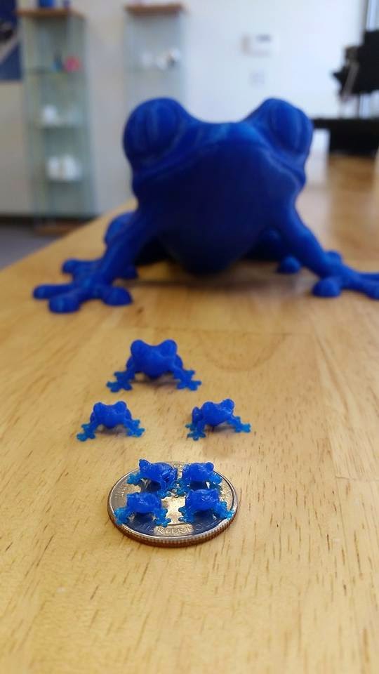

Originally shared by MatterHackers Just micro-frogging....
Just micro-frogging…
Details please? :wink:

Those tiny frogs look out of reach for a FDM printer. Or, the process of a lengthy and painful calibration process. Impressive. What are the layer heights, and nozzle dimensions?
Well there was a great deal of calibration, but mainly because we’ve never printed that small before.
The first 2 micro frogs were at .15mm layers. .40mm nozzle. 2 perimeters. 20% fill.
The next 2 were .08mm layers.
We printed 2 at a time in order to give ample cooling time.
Print speeds were very slow. The results are pretty awesome.
Now that we know it’s possible to print that small, we have a .25mm nozzle to start playing with.
