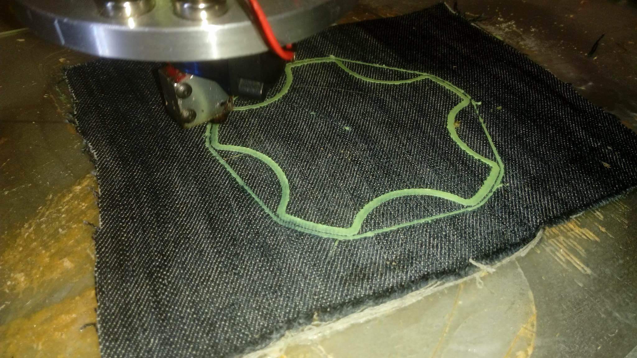

@Darkberg_Aryavis ​ today try something I suggest and I currently can’t try because no stay in my country :slight_smile:
Print abs on jeans without hotbed…him make fast and dirty test.
Him need fix better jeans and leveling…my opinion as first ABS print are amazing diameter of tree are around 110mm using http://fdplas.ru filament
Interesting Idea, i nver had problems with abs even on a reg bed, but mind you I didnt print large objects
@Matthew_Del_Rosso ​ possible, need more test (currently spiralize and only bottom 110 diameter) but see that in optic where no have hotbed or can’t add it or no want/can’t spent over 200w for make hot the glass. that ideal other my friends on fb testing it with solid small part an work fine.
I’ve printed with PLA and TPE on fabric before. It worked quite well. I just made sure the first layer was very squished to get good adhesion.
