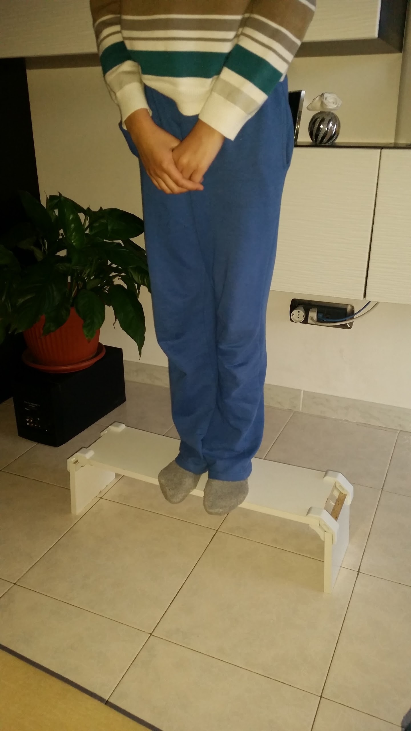

Originally shared by Mauro Manco (Exilaus) first use of my wood joint....
first use of my wood joint… really great success in pla 40% infill printed with @MakerGal mendel max xl.
for information my son now around 40kg :slight_smile:
#print #recycle hardware #finiture #fablab #firends = #SUCCESS !!!
#ilovethiswork
http://www.thingiverse.com/thing:2193444
Are you orientate it before printing for better resistance or just as you want to? (Just curious)
Nope I using last file 4pcs 90 and if see 2 are horizontal other 2 vertical and using cura 2.4 where infill are better managed

@Lykle_Schepers i’m happy for that, if see design have 2 hole that for wall mount. If need different angle published on thingvers and no have onshape account you will ask me and i export it for you.

That my first apply on my new small desk in office:(, just recover lot of space but want add on right other shelf for add paper container and have free desk for second laptop or desktop :slight_smile:
