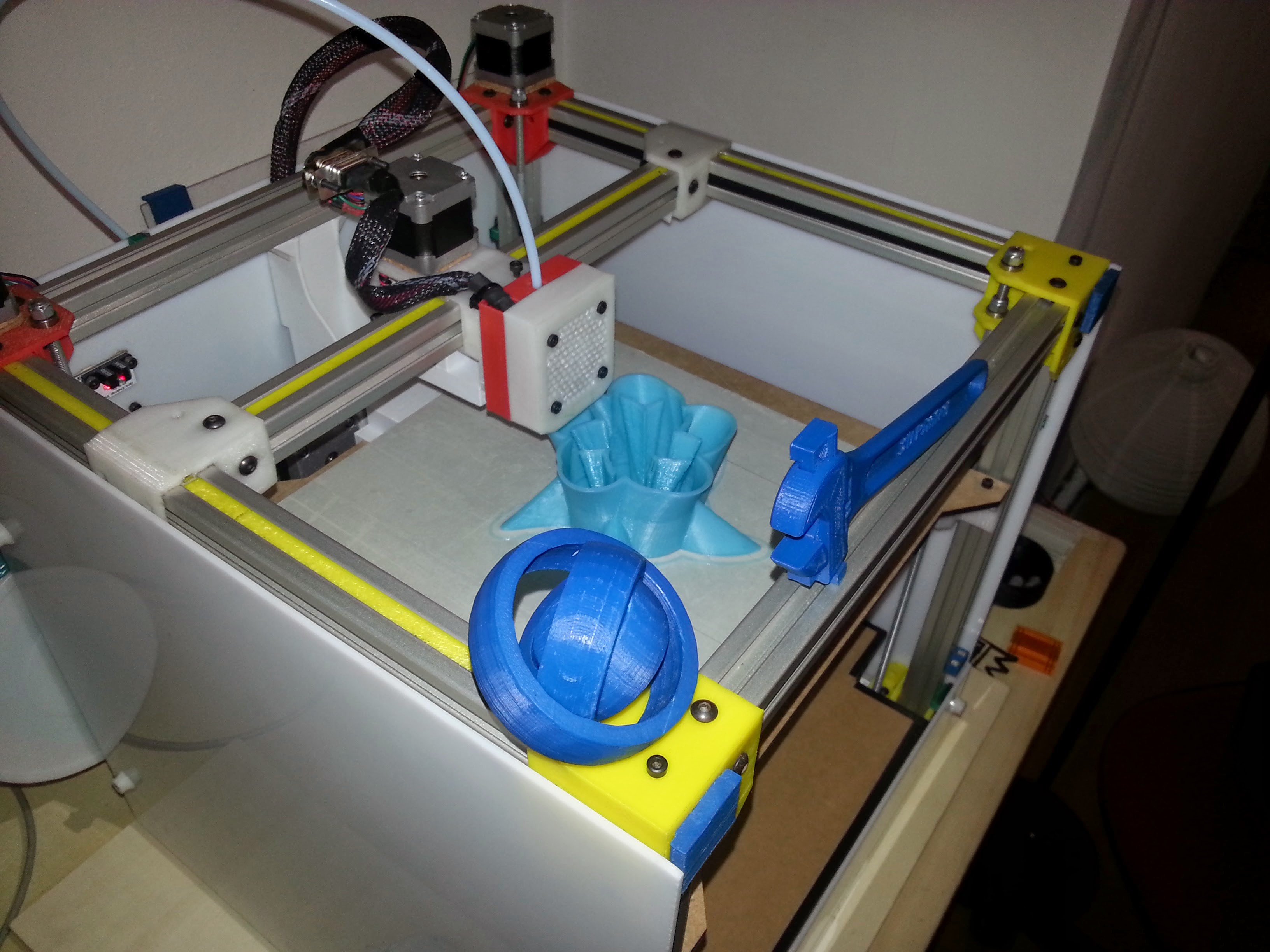

Originally shared by Mauro Manco (Exilaus) Hands on fa)(a 3d....
Hands on fa)(a 3d… Amazing acceleration and really fast print(on video is set at 90mm/s for have best quality). very Lite noise if compared with powerwasp and print fine and clean with defaul 0.5 noozle (Huxley Hot End) !
Very interesting the sliding bars, did they have integrated belts?
Yes Stefano belts are inside tslot (black line) hope you and Giacomo see this October in Maker Fair Rome…sigh I need write my presentation or i stay at fablab romamakes stand :slight_smile:
Very clean design, I hope too. We are preparing the proposal to participate again to the Maker Faire Rome with the new BadPrinter2. Keep up the good work :slight_smile:
@Mauro_Manco what about the yellow stuff in the top slot? What is it and is there anything that slides on it?
Also - no matter how I tried I could not find the Z motors :slight_smile: Will there be any more details descriptions of the printer?
Hi @Igor_Larine Inside yellow printed item are present rare magnets. Fa)(a have xy magnetic rails and z four piece of m5 and z motor stay in on base and move all 4 http://screw.as you see all belt or cable are most invisible . Have multi language site (http://falla3d.com) and all project(sketchup files) and bom list are in github. Currently business format are make it in a dedicated workshops (falla trasladed in eng is “made it”) for 660euro each base printer(HB he 0,5 nozzle electronics without display and without external pannel)but is ready for dual extruder or FUM(make same from @Giacomo_Falaschi 1 he and 2 motor for 2 different colors) .Surely need write some more documentation but if need and want more information we are here for this.
