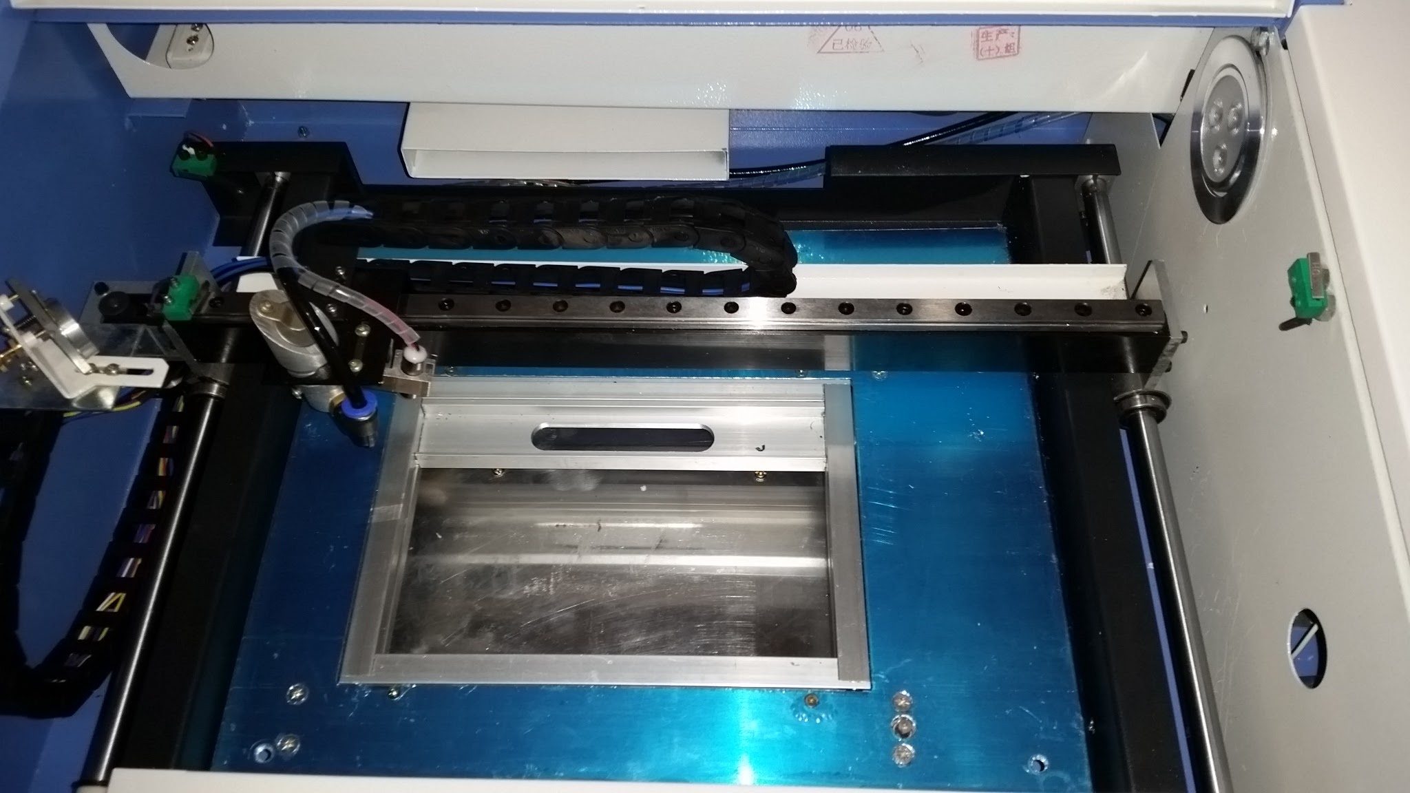

Originally shared by Mauro Manco (Exilaus) Ok tell more on pimped K40 from factory.
case… cutted right dimension of suction blower
-manual z table working but a screw come little out and very hard to rotate.
-metal air assist just mounted
-light
double round bar for y and linear guide for x
  • switch on back and frontal (machine contine work but stop laser)
  • horrible wiring cut.
  • temperature tube…but no any switch for stop laser,
  • frontal panel good emergy button and key,… no like digital set power.
  • same board of k40…only corellaser…
…my impression for price (around 700euro with tax and other)
better hardware for move, lens and mirror support are little better of k40 but not high quality same u can find on HK 5030 .
z hackable with stepper/dc high torque but need dismout axis and default board can’t manage…and i no love quare hole place in this laser too.
Poor board same k40 no dsp…and fake temperature tube are ridiculus. have better check sistem for back and frontal door but this are only 10min and 2 switch.
full change with ramps/smothieboard needs or add DSP for have no issue laser machine.
inside find water pump…but we no use and changed with a chiller.
