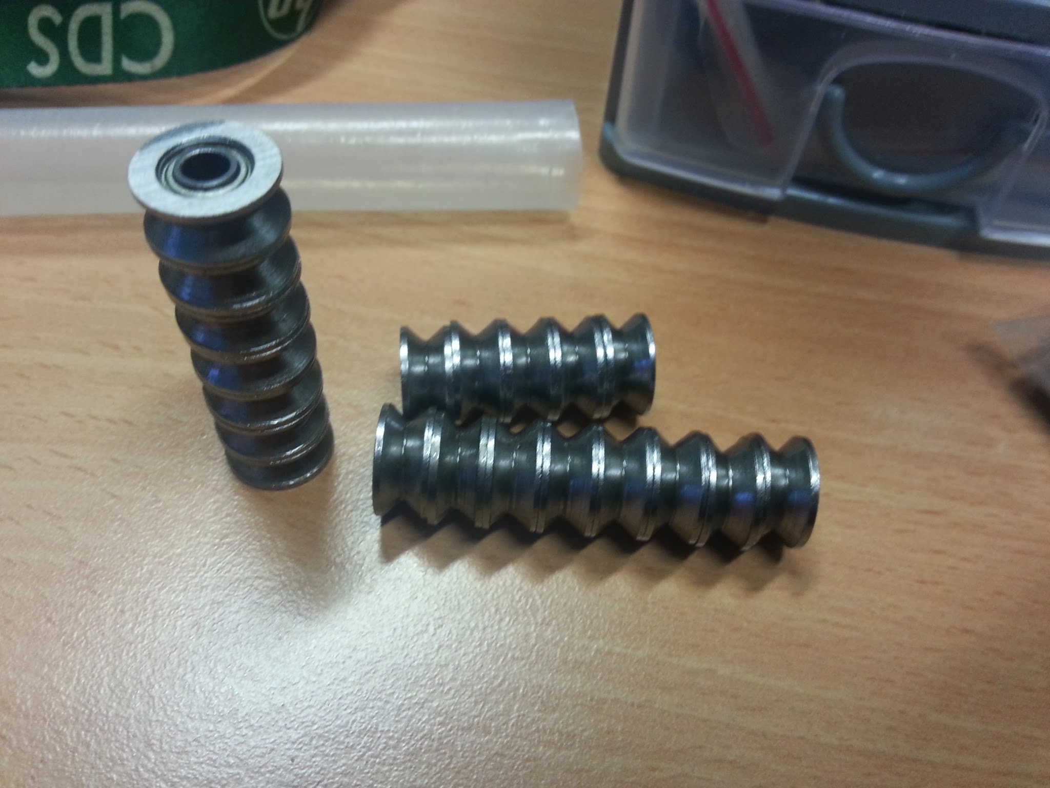

Originally shared by Mauro Manco (Exilaus)
@Shauki i think better use this 624zz for zstage cost a cents…but make soft wear if push hard…but resolvible shrink tubing
I use them on my delta for the carriages. They wore the chrome of the chromed square steel tubes. I tried shrink tubing them but I wasn’t happy with the motion. I ended up putting kapton tape on the tube corners. Seems to hold up ok and is easy enough to replace if needed. Would probably work even better with uhwm tape.
