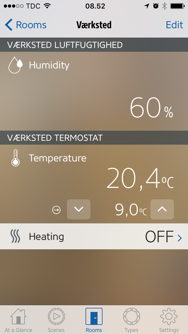

“Everything is Connected” - with MQTT.
The attached picture is a screendump from my iPhone. It shows the humidity and the temperature in my workshop. Humidity and temperature are read from a simple DHT21 sensor. This sensor is connected to a ESP-12 board (it also have some relays connected which in turn are connected to a couple of heating elements and a fan to actually provide heating in my workshop during winter time).
The firmware on the ESP-12 communicates via MQTT. I have a (mosquitto) MQTT broker running on a Odroid-C1 in my home. Also on the Odroid-C1 I have a “HomeKit to MQTT” server application running. This application is using http://github.com/brutella/hc for interfacing to the HomeKit world and Paho MQTT to communicate with my MQTT infrastructure. The data transferred via MQTT is more or less the HomeKit format in JSON. Topics are
