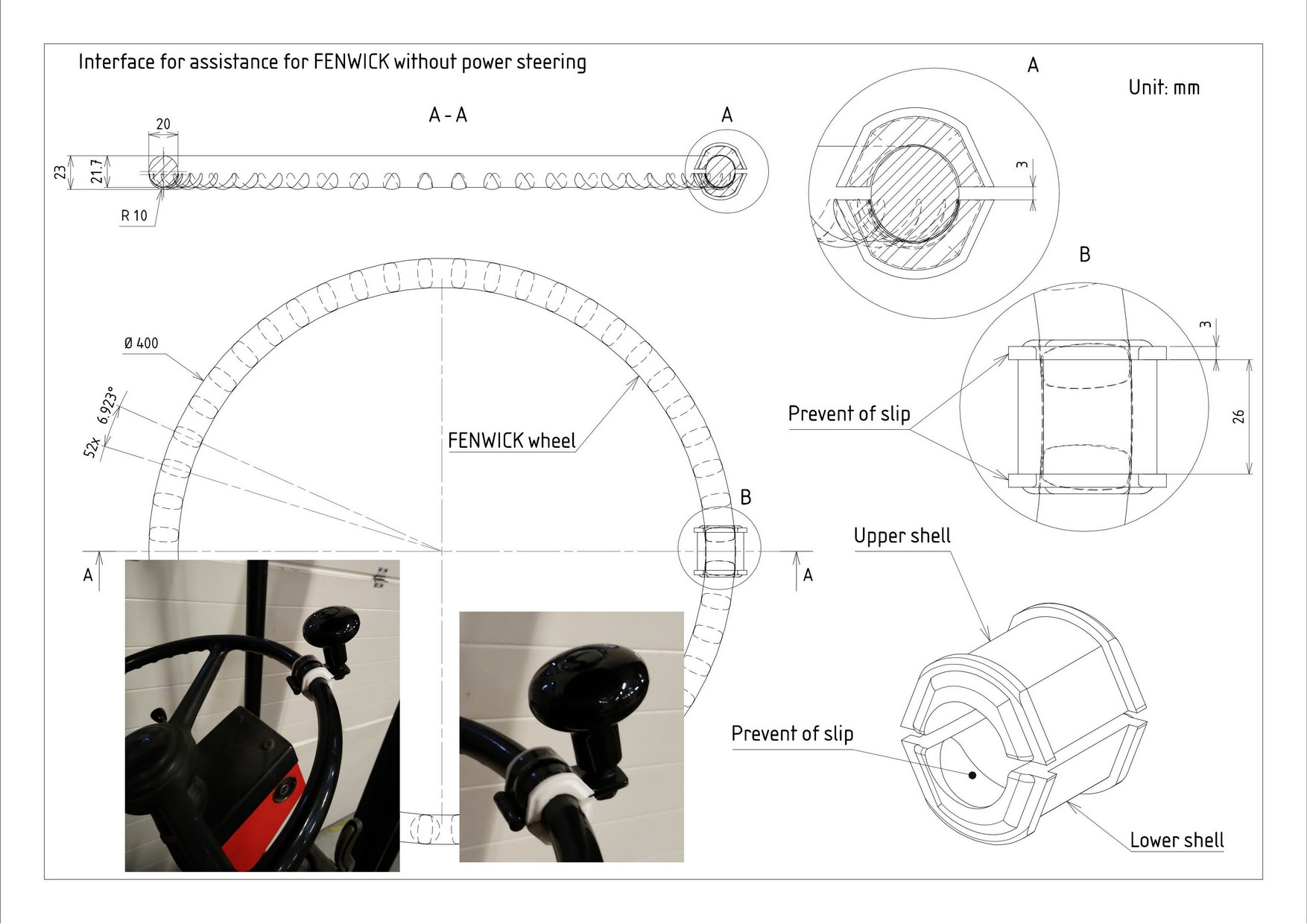

How 3D printing can be usefull at work? (2nd part)
Do you remember this:
https://plus.google.com/115671562824621394958/posts/gMzyMUzCt5G
Our forklift not have power steering so we bought a device to help us to gear easier. This device was not designed for our wheel so I 3d printed an interface… and now it’s working fine.
@Mark_Rehorst
:slight_smile: I learn something today. Our forklift is very heavy.
Be sure to check your local laws. For example: “U.S. Occupational Safety & Health Administration regulations restrict use of auxiliary devices for specific construction vehicles.[6] OSHA prohibits modification of industrial equipment without the approval of the equipment manufacturer.”
