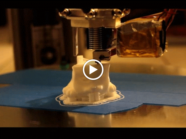

Originally shared by Michel DA SILVA
I solved the noise of the enclosure but it is still a sound that I can not delete ( independent of the enclosure ) . The noise comes from one column , I stretched and relaxed the belt but it did nothing.
sounds like the nozzle scraping over the previous layer.
@Rien_Stouten It’s not from the nozzle, noise come from the column. The quality of the print is really good, if it was from scraping the part will be affected.
The rubber seal on one of your bearings maybe.
+Michael Scholtz it’s more than possible… I am looking at it printing a big part and i think i will try to change the bearing.
It could be the bearing itself. Try and turn the bearing and see if the noise changes.
I removed the bearing… It really came from the bearing :). Thank you so much, now it’s super silent and i still didn’t have doors and roof…
