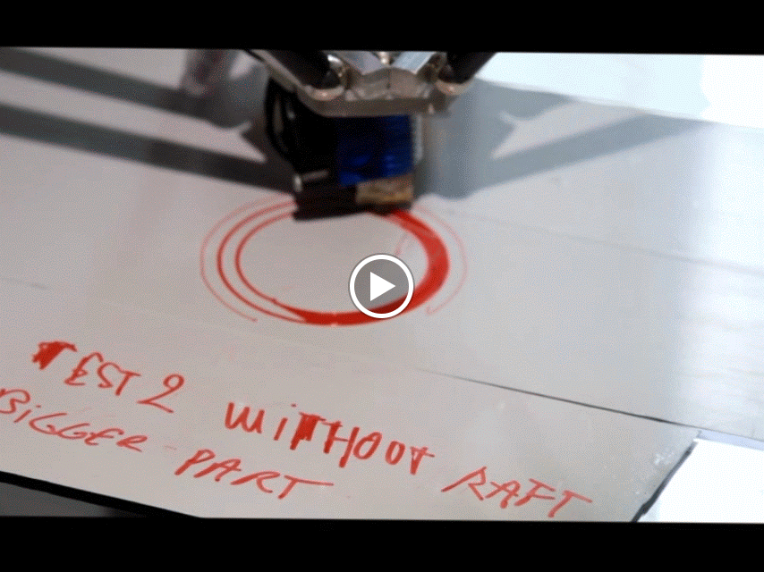

Originally shared by Michel DA SILVA Laser film Test2 PLA 210°C,
Laser film Test2
PLA 210°C, bigger part without raft, NUT M50
Aim:
-no more blue tape
-no more hair spray
-no heated bed
-better surface quality
-longer life
-more economic
@Rene_Jurack I am still making test, i am already exiting about thé results, i didn’t mean that it will work for evrything, but i think i can already print 90% of the parts i use to print.
What I am curious about is: How “clean” do you get the tape off of the printbed in case you need to change it? The lasercutted parts I used to deal with are covered with this tape and it is easily and extreamly clean to remove, EXCEPT at the points, where the laser did put heat into the material. There is this loose glue sticking on the sheets and I have to remove it with petroleum benzine or similar… The filament is putting heat into this tape, too… So can you just pull it off without any hassle?
@Rene_Jurack Yesterday I already change it 1 time, coz I got an electric shut down and when electricity came back my head bumped on the bed, it was 220°C, it leaved a small hole. I didn’t have any issue to change it, I use alcohol to clean. My bed is a miror. What’s is dificult is to put it whitout to make some air or dust bubles…have to use something like credit card.
