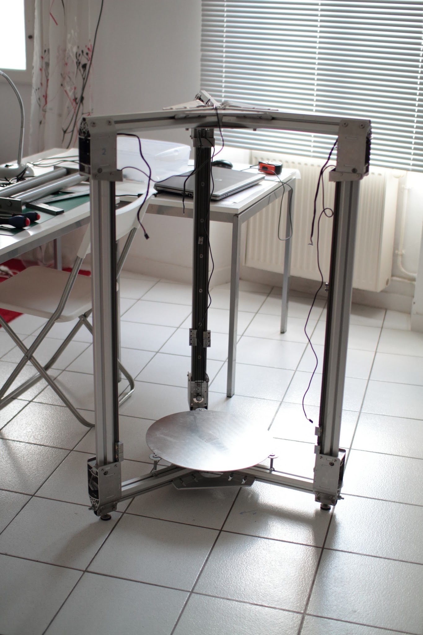

Originally shared by Michel DA SILVA My printer PHASE 2 near to be finish.
I was hoping to get the carriage’s plates today but I didn’t get it (I order laser cut). My design is modular every parts can be moved. Here I turn the columns in order to have the carriage inside but before it was working with the carriage outside (good prints but too much shaking when the speed was higher 100 mm/s) .I have changed linears bearing for IGUS DryLin® W Linear Guides with adjustable clearance. Maybe I will have to solve soon some issues with hyperstatism…
