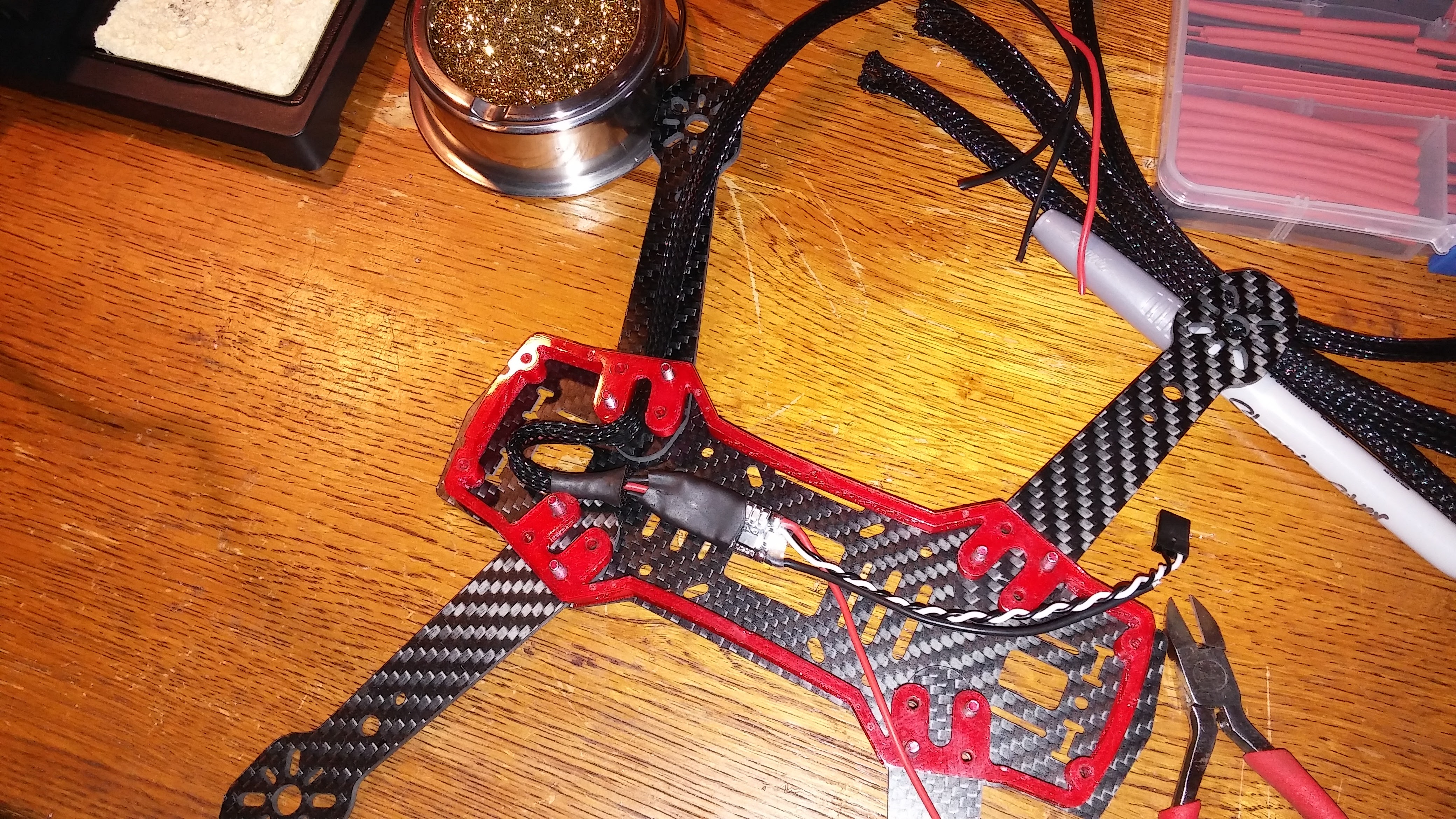

Got my littlebee esc’s today. I got the motor leads soldered on and trying to figuring out placement. I am hell bent on tucking these little guys between my spacer. I am just not a fan of that huge hole in the center of the bottom plate. Doesn’t leave a lot of surface for sticky tape.
Any ideas on how to secure these? I could zip tie them, however what you see of the esc is about it. I have way to much heat shrink on.
Personally, I have my escs on the arms. I put double sided tape between the esc and arm then heat shrink over the whole assembly.

As I am a noob and will likely be more loitering around and replacing props. You think heat will be to much an issue?
I do like the idea of the escs being hidden, but not at the expense of contanly replacing them.
in my experience, running 1800-2300kV motors and 12A escs have yet to produce a significant amount of heat.
I went ahead with them in the spacer. I have one each infront of the arms, and one on either side of the center square.
Still doing a fairly dry build, but it is looking really clean. Will post another pic once the pdb is solered up.
I’d use some thicker, not so dense, 3M double side tape bro, the area is enough to hold on to the ESCs, you could also go with Velcro actually
3m tape is exactly what I used. After relocating 2 to the front/back, there was ample surface area.
