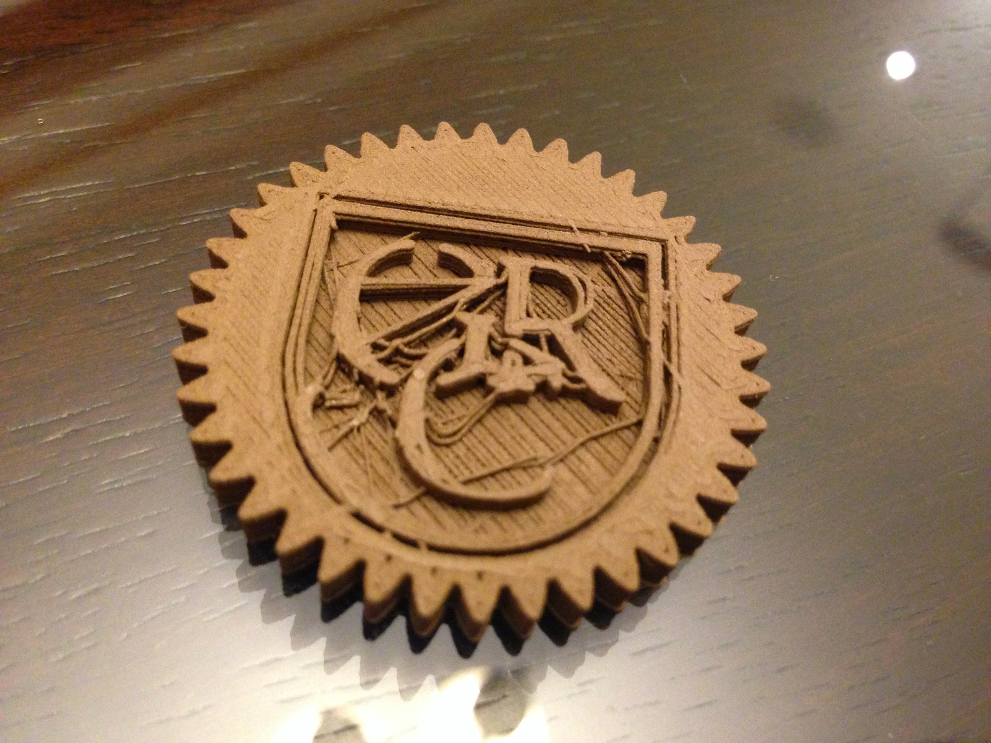

Originally shared by Patrick Ryan
First test print with colorfabb bronzefill. I’d call this a “qualified success”. I didn’t have any coarser sandpaper than 120 grit, and that really wasn’t enough to completely eliminate the printing lines before buffing it to a sheen with 240 grit. Topping it off with steel wool did nothing other than pull off some of the more delicate structures. Next time round, I’ll be sure to have some 50 or 60 grit on hand to start the process, and maybe finish with a 500 grit wet buff. Getting some nice sheen even so!
