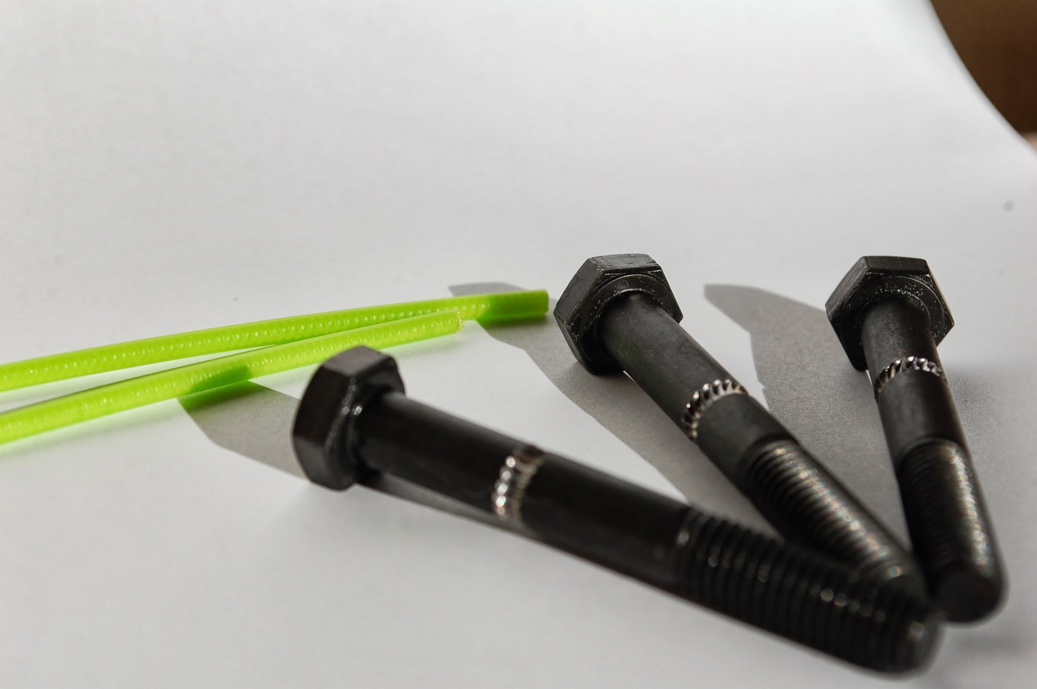

Originally shared by Paweł Dobrowolski Some milled hobbed bolts:)
Works better if you use a thread mill.
Well, I did it using 1/8 end mill and my new 4th axis:
Moreover, using 4th axis I can make any tooth I want :wink:
Cool
That tooth profile sure looks interesting - very sharp and grippy for pulling the filament in, but enough material behind the tooth to keep it from bending or eating into the filament too much.
