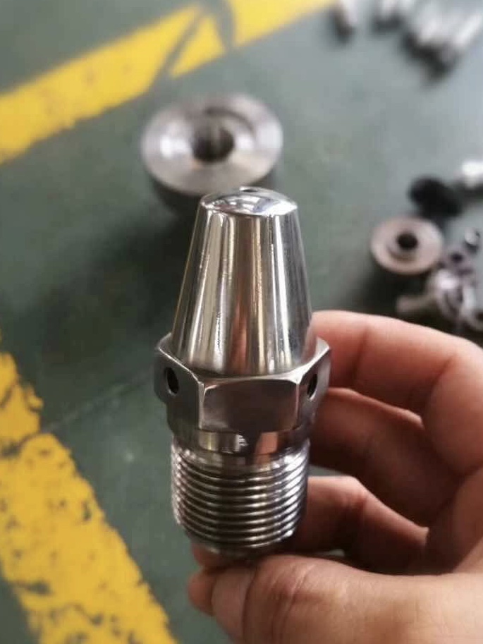

Finally got hands on the nozzle for my next printer :heart_eyes:
Okay, two questions chuckle:
  • What nozzle diameter is that? :slight_smile:
  • How do you get that thing to temperature (and keep it there)? Purely at a guess, even the famed E3D Volcano could kinda, sorta have a hard time keeping up with that… :wink:
@Ingo_Ulrich In the pic, it is 6mm.
Heating is done by generic ring heaters, several of them and with different temperature areas to preheat and premelt the pellets.
what do you want to print with this? a house?
6mm wow!!! I was expected to test a big nozzle on my printer like 1.2mm hahaha! You will make very big stuff. I have to see that.
@Rene_Jurack So, sizewise somewhere dead center between the ‘standard’ 0,4mm nozzle and the ‘print your own house in concrete’ size… Okay, the printer for those has got to make the Parts Daddy look small in comparison…

i wonder if on those dimensions some iris (non overlaping) or needle (valve) would be beneficial.
@Ulrich_Baer would definitely want a valve or a positive displacement pump or something for concrete. A quarter-turn ball valve might work well. Big plastic injection machines often use back-pressure check valves so a little pressure is required to get them to start extruding, which is a nice passive approach.

No valve or such needed, I did clever on the nozzle-geometry :sunglasses:
@Rene_Jurack hope you will show - when it is time!
Is that for the stainless steel filament?

very big nozzle
