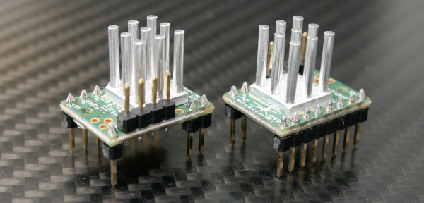

How about a Smoothieboard with the most silent drivers available? And as if this wasn’t enough, there are also 6 of them! @raykholo @Arthur_Wolf #multiextrusionproblems #cantgetenough #smoothieware

Nice, what are the blue and black bridges on the drivers?
@Nicolas_Arias needed to configure their behavior. These are TMC2100 “silent stepsticks” and with this bridge, they are running in “spreadcycle”-mode. There is also a even more silent “stealthchop”-mode, but it is too weak for most usecases in 3d-printers.
@Rene_Jurack ah, that would explain the low torque I have been hearing about, and good to know there is a way to overcome it while still remaining quiet.

@Rene_Jurack any luck with those 2130’s on smoothieware? Trying to do similar
I’m sure Rene is using the 2100’s
Yepp, standard TMC2100’s in the picture. I don’t see the need for 2130’s AND the amount of work to get them working and using their advantages above the normal 2100’s…
