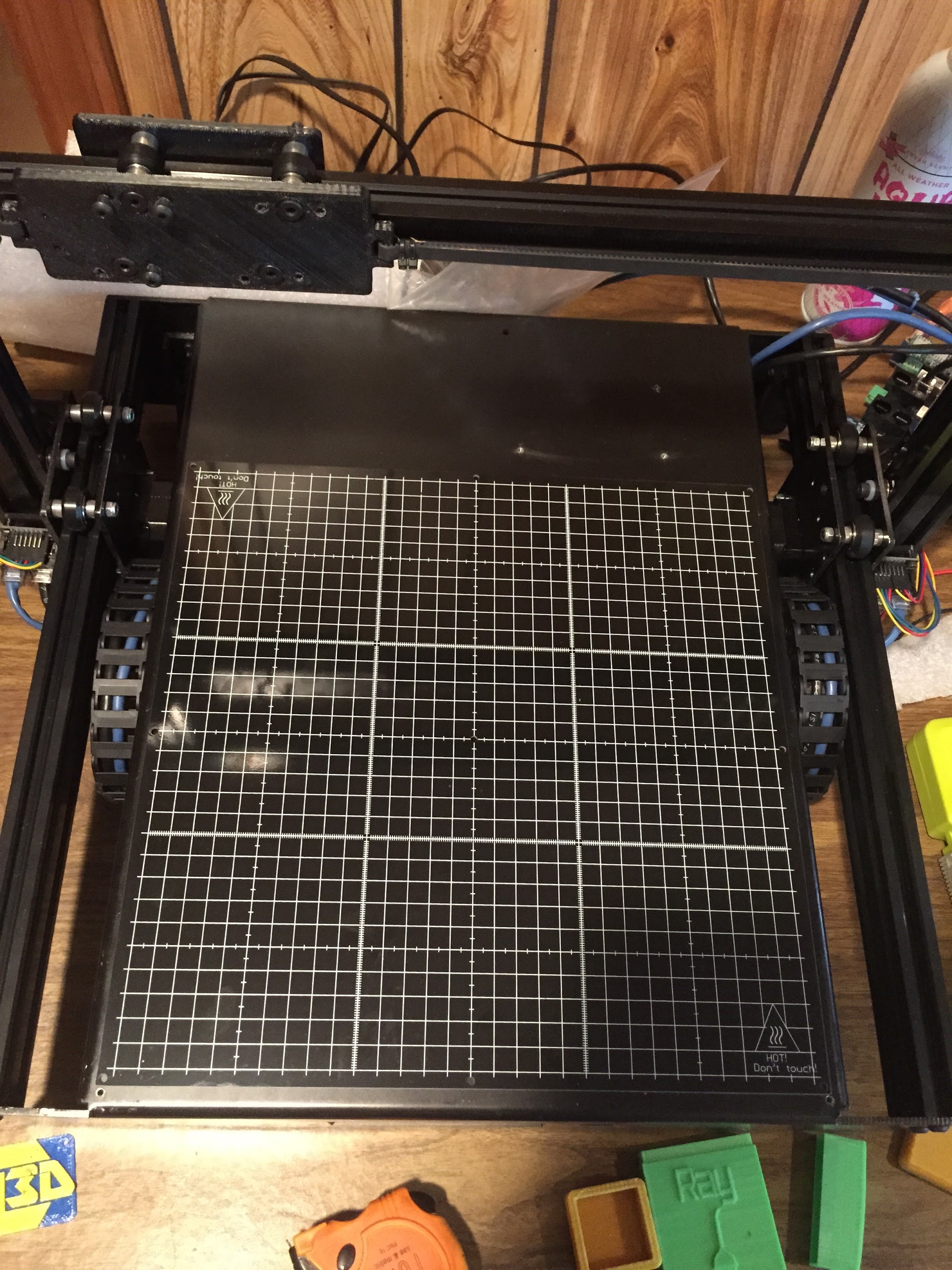

Or a 300x300 PCB Heater. But realistically any bigger and we are in AC Silicone Heater territory.

Oh no objections there, but I did get the PCB heaters for 200x200 and 300x300 b/c I felt they would be easier to deal with (for a quick one or two off design) than having to get a metal heatspreader made for adhering the silicone to. I can just put glass onto the PCB heater and be done. Otherwise, yes, silicone heaters all the way.
