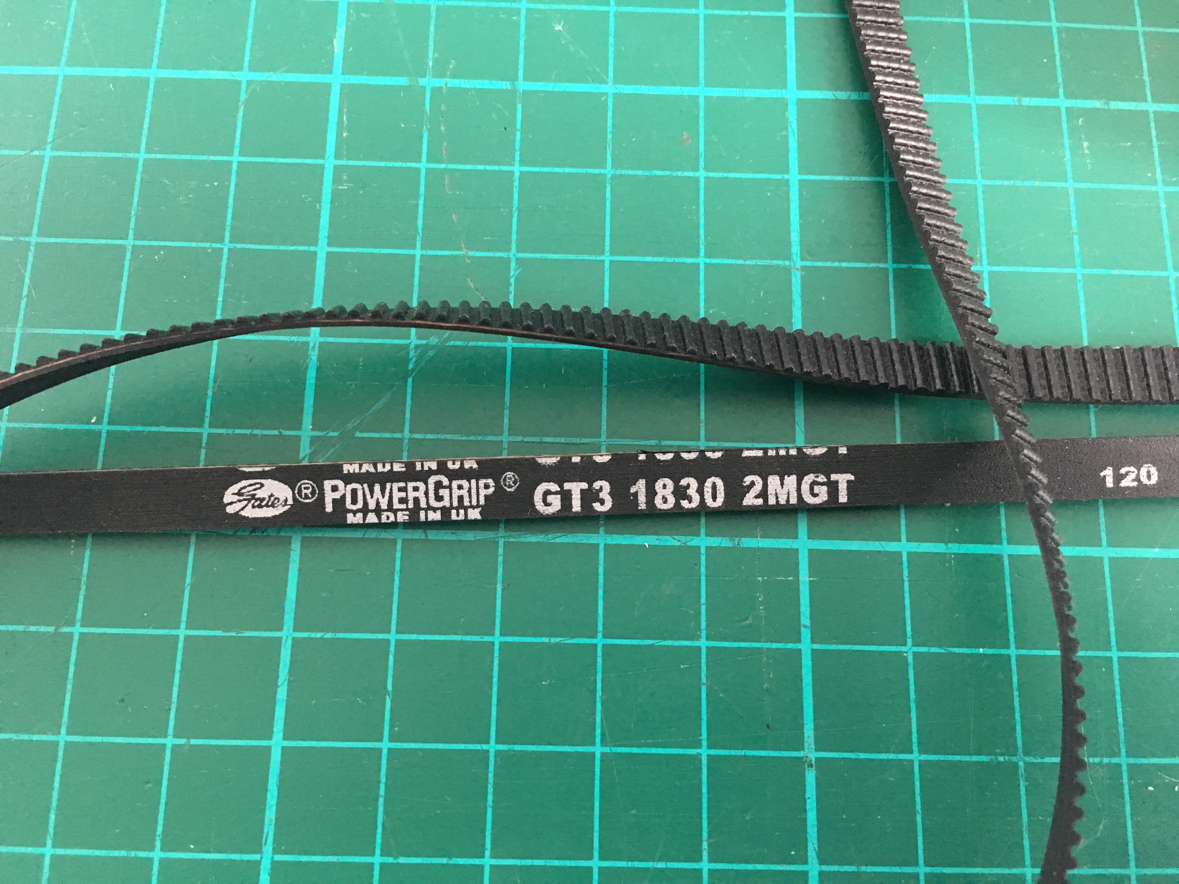

Originally shared by René Jurack
Let’s see, if a genuine GT3 belt does affect the ringing…
Holy crap!
@Griffin_Paquette Holy crap? Holy crap, a genuine belt? Or: Holy crap, that is baaaad ringing?

@Eclsnowman as far as I know, every firmware does it pretty much the same as Marlin. Which means, it decelerates towards the corner, and then it accelerates when it leaves the corner. It does this at the configured acceleration. The “magic trick” is the “jerk” setting (which has little to do with the official jerk, which is change in acceleration). This jerk is an instant change of speed. So at the corner, it’s not at 0mm/s. It will be at 0.5*[jerk-setting] and it will leave this corner at 0.5*[jerk-setting].
This is actually the main source of ringing, but setting the jerk to 0 will cause other effects. So you need to find the sweetspot for your mechanics.
