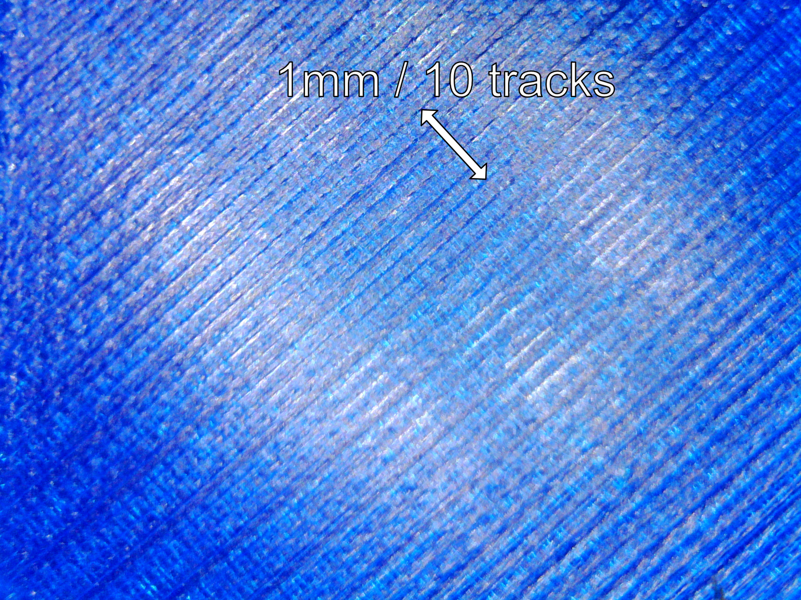

Originally shared by René Jurack Smooth Toplayer without visible tracks:
Smooth Toplayer without visible tracks: Just set extrusion-width and layerheight to a crazy tiny setting for the last couple of layers.
In the pictures: 0.1mm extrusion-width / 0,05mm layerheight / 3 toplayers / nozzle in charge was a 0.3mm microswiss.
Filament was blue PETG, the layers are so thin, you can see the layers beneath the surface. Under the microscope, it looks like transparent filament, but it isn’t :slight_smile:
I don’t use Cura, but isn’t that what its “Ironing” (a.k.a. Neosanding) setting does?
@kongorilla yeah, though ironing only does this for the very top surface (not for 3 layers as op suggests).

Rene great up close shots. Question, are the top layers brittle, malleable or is it still ridged?
@Jeremiah_Coley It has a matte finish without any visible lines or grooves.
