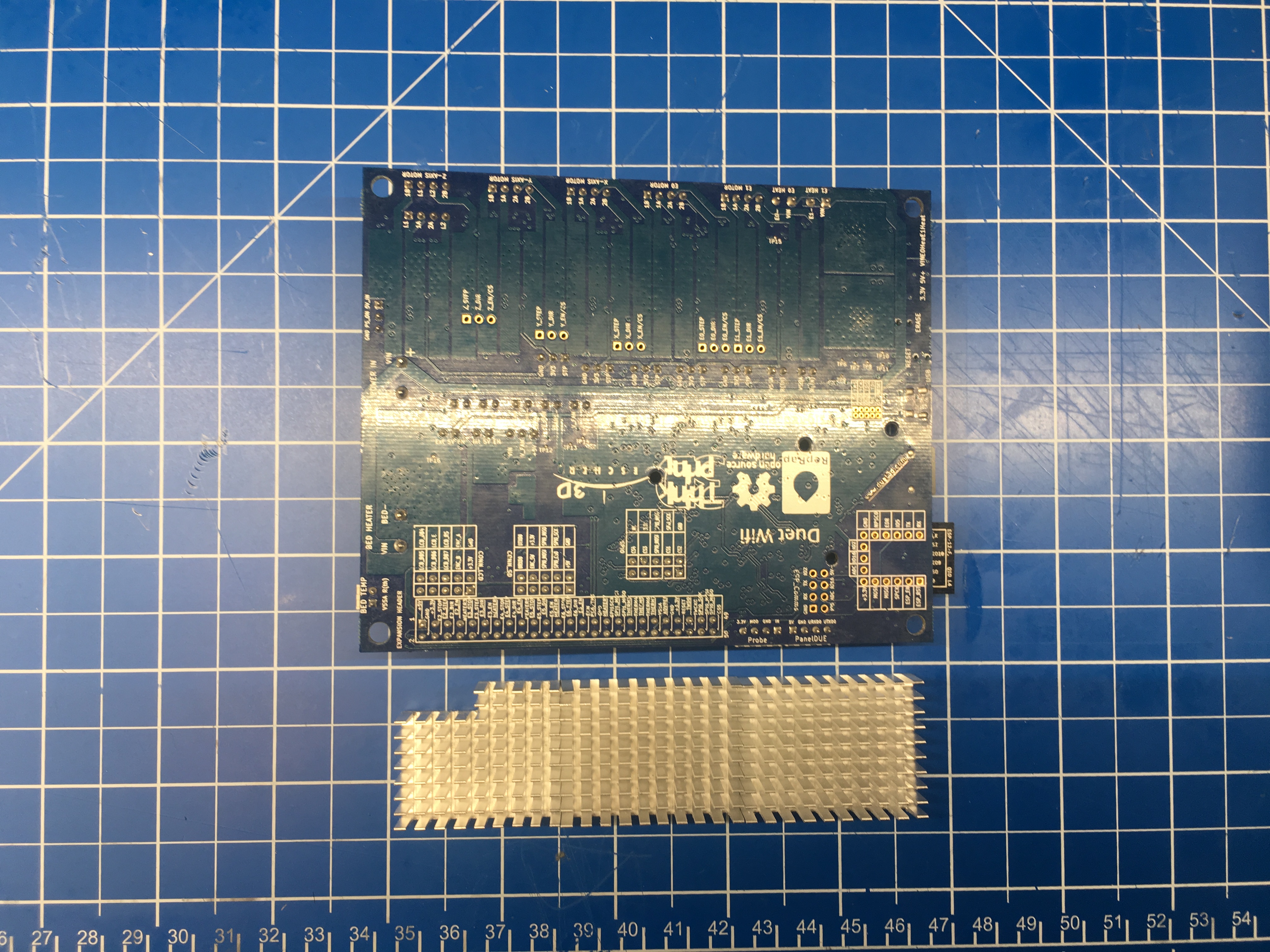

What is your cooling solution for the DUET? I had to tinker a bit, bc at 1500mA or more the drivers did start to overheat, even with a fan blowing to the underside of the board…

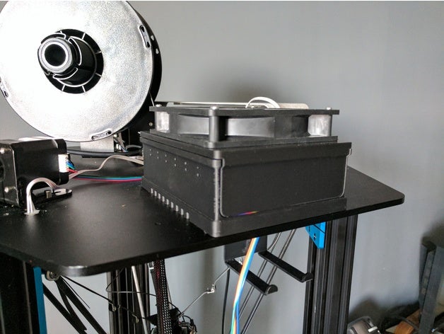

I converted my Tevo Little Monster to Duet: It already had a case for the smootheiboard knockoff it had, and with an adapter I could fit the duet in there. It has a very large (but silent) fan on the top blowing down on the whole thing. However, someone made a 3d printable version of the whole thing, you can get the idea from the pics here:
