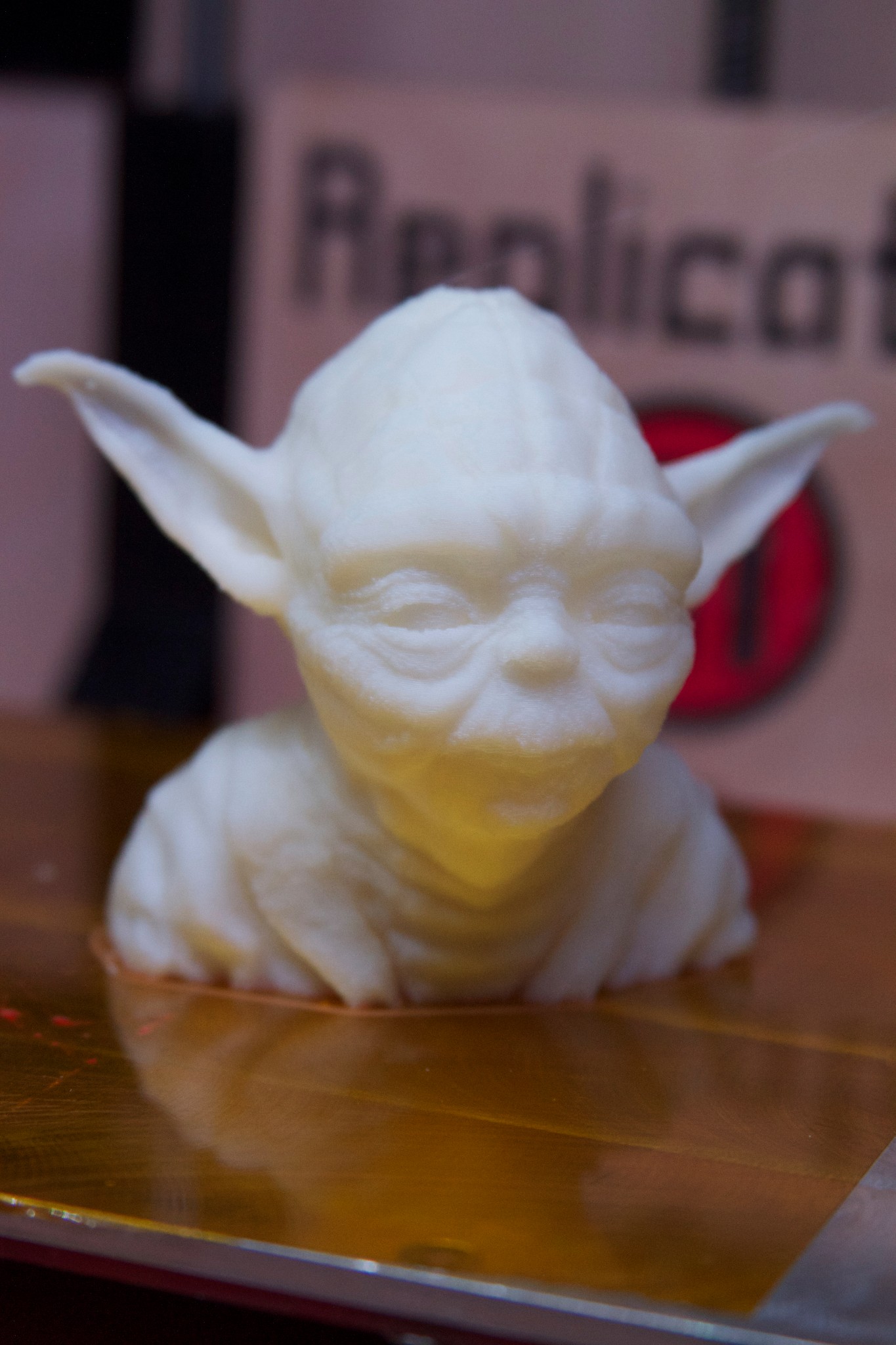

Yoda, printed at a layer height of 0.15mm.
Other stats:
“Natural” color ABS (MakerBot)
50mm/s perimeters, 80mm/s infill, 150mm/s travel
Replicator 1, custom firmware, no hardware mods.

I should note that this is uncleaned, still stuck to the platform. I shot the photos in ways that would highlight the glitches.
