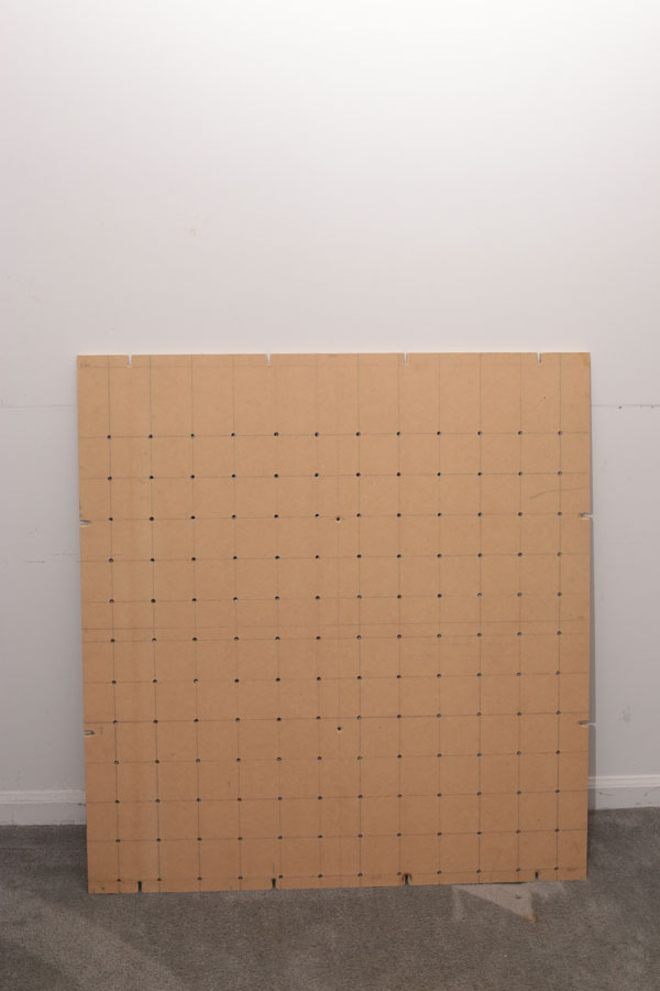

Wasteboard for my X-Carve upgrade
Bought 3/4 MDF board and made my 1000x1000mm wasteboard for my CNC. I had 500x500mm Shapeoko2 CNC and I’m upgrading it to a 1000x1000mm X-Carve. I followed X-Carve grabcad files while making the wasteboard.
Used a router to cut screw positions. Furthermore, used the router to make corners 90 degrees, given the guy at Homedepot made few errors.
