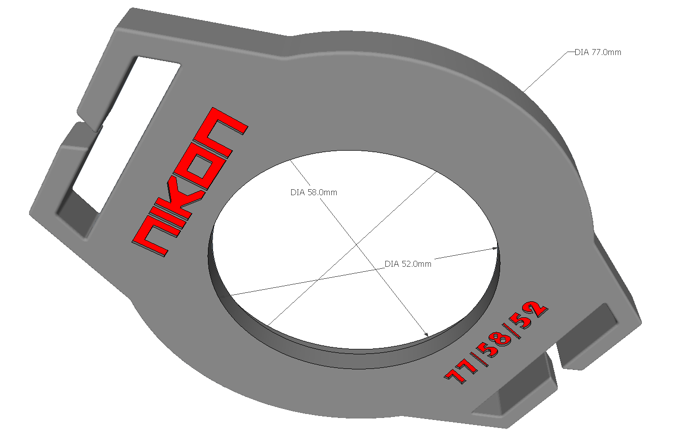

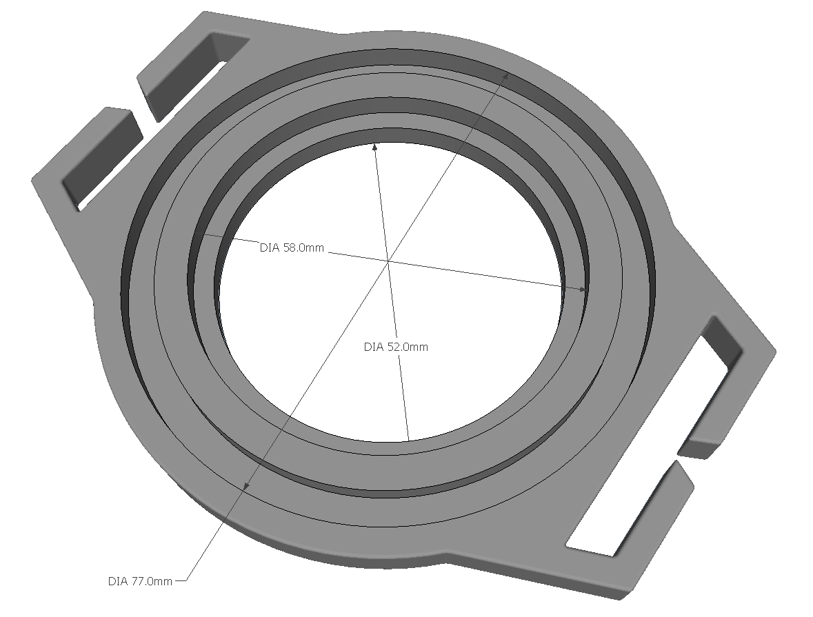

Dad needed a single Nikon compatible lens cap holder that would work with his 3 different lens variants (77mm, 58mm, 52mm) so I sketched him up one (dual sided) and am now testing printing with smoke tinted T-Glass filament for the 1st time (240c @ 100mm/s, 40c bed). Not sure how this print will fair; testing is 1/4 of the fun.
