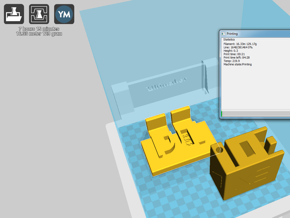

Printing in silver PLA Google Glass Base 3.0.3. With the bump up in scale time to print has greatly increased…
7+ hours to print. If you can’t sleep like me watch along with snapshots @: http://mega.dlinkddns.com:4445/snapshot.cgi?user=megaweb&pwd=1l1k32v13w
Settings:
Ultimachine PLA, 100mm/s, layer height .15mm, all wall thickness .8mm, fill 20%, flow 100%, retraction 40mm/s (distance 4.5mm)
