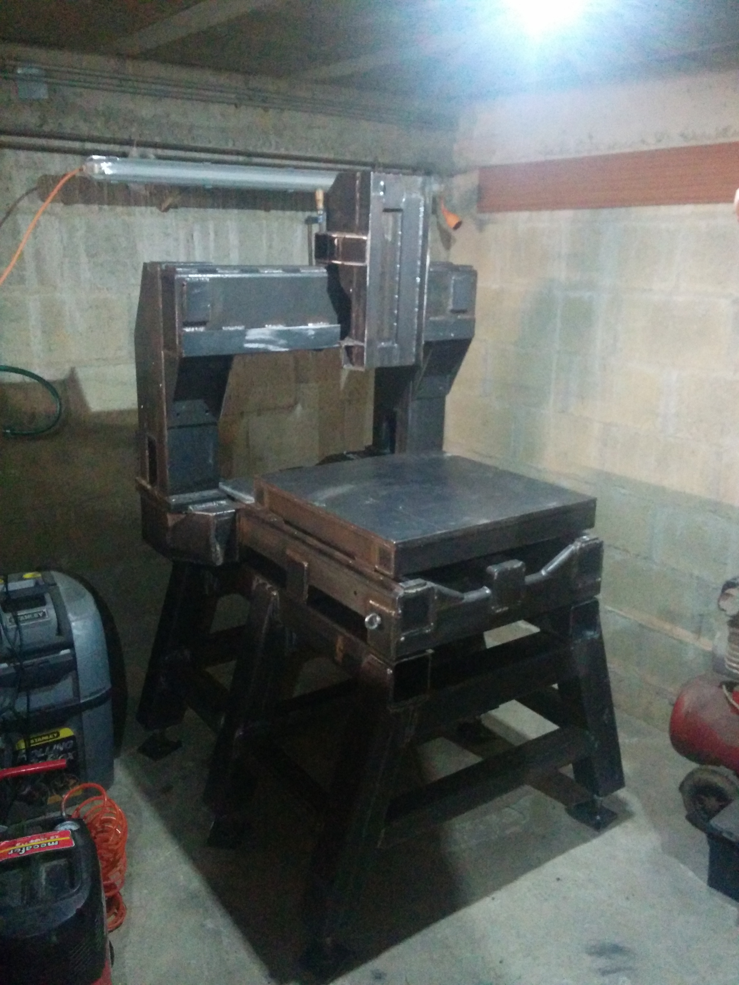

Originally shared by Sam De La Haye Finally on its own feet!!! Slight chance
Finally on its own feet!!! Slight chance of plan on the rails, rather than going with round rails which is on the wooden prototype, I’m looking into getting some roller bearing rather than ball. Would love THK but bet there’s a hefty price tag if I can find them! In the mean while I’m building a second machine with the leftovers from the base, as I need one running for other projects!
