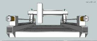

Originally shared by Sam De La Haye
Some of my old basic designs I thought I might share, might give some ideas or laughs!!!
They seem like reasonable designs. The biggest design flaws I see in most designs (commercial as well) are wimpy uprights for the gantry and just general poor use of materials that end up way too heavy on the moving parts.
@David_Kirtley I would agree on that! The amount of knowledge I’ve gained in building the wooden one alone has been invaluable. I guess in wood its easier to see where things start flexing, moving and doing everything you don’t want them to do!!
