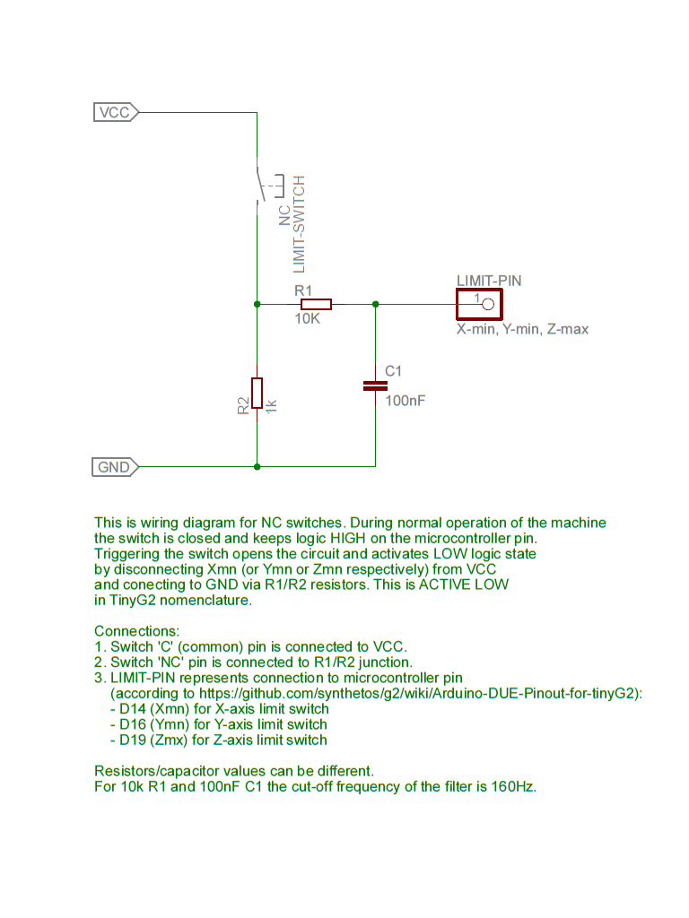

It looks that the wiring method I am using in my setup (NC switches wired with pull-down resistors to GND and switch mode in settings.h set to ACTIVE_LOW) has not been described.
I have to state here that the method of wiring NC switches with pull-up resistors connected to VCC and switch mode in settings.h set to ACTIVE_HIGH, which is presented in the source files comments did not work for me. It conflicted with the probing process.
I am using two NC switches for each axis wired in series thus both sharing a single pin of the microcontroller. This way I do not need to use Xmx, Ymx and Zmx can be used for Z-axis limit switches. Zmn is used as PROBE pin.

- I wired all connections according to diagrams attached below to this post.

With this setup the limit action triggers every time a limit switch gets hit and the machine gets SHUTDOWN state. Homing works fine, too. The PCB probing works as expected,
I did not get any false positive since I have set it all up. My limit switches are all enabled in the configuration ($lim=1).
Why I prefer using NC switches? If the wire gets accidently disconnected/broken the machine will report ‘limit action’ and remain in SHUTDOWN state until the wiring is repaired or the user clears the alarm with $clear. But even so, a user will be aware of the problem.
