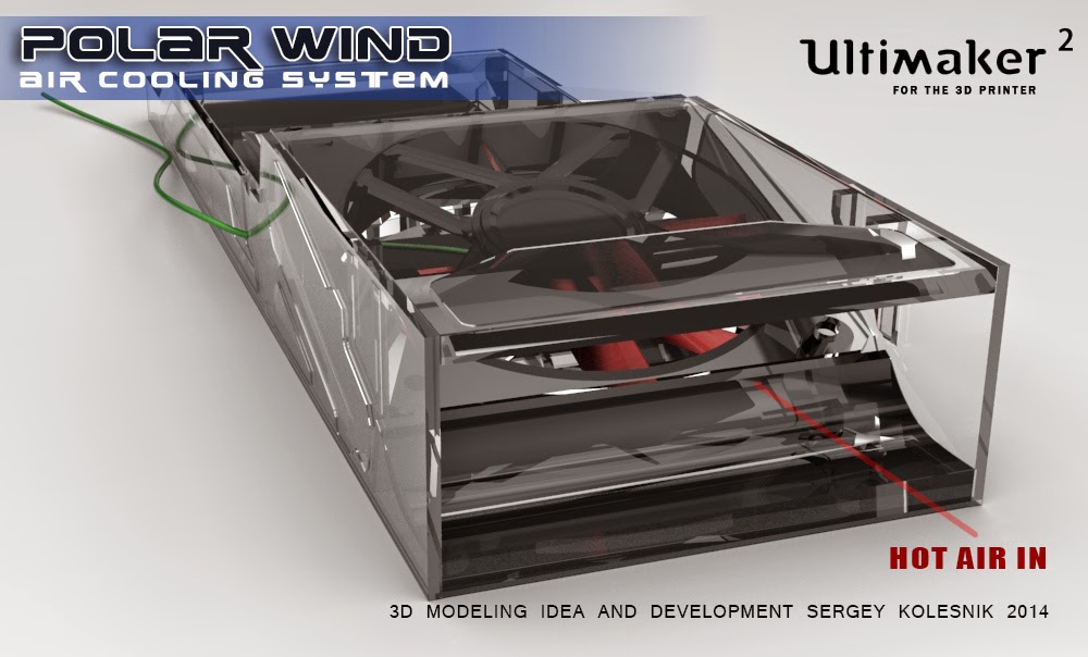

Originally shared by Sergey “3dpicasso” Kolesnik Hi all ....in my room sometimes very warm
Hi all …in my room sometimes very warm above 30 degrees Celsius. I noticed that at the bottom, where there is a micro computer board printer, too much heat at the bottom. and little air movement. within two days, I developed a system of heat blowing from under the printer. this device I called the “polar wind”. it works on the fan from USB. and is designed for installation at the bottom of the printer. blowing hot air into the side of the board micro computer. air cooling system for the printer.tomorrow I will start printing 3d…
Don’t use a axial fan for a solution such as this. You really want a radial fan (“squirrel cage”). Radial fans produce a higher pressure, and are meant for enclosures such as this. They’ll move much more air.
@ThantiK I live in a small northern town. happiness for me here to find a fan powered by usb…:slight_smile:
