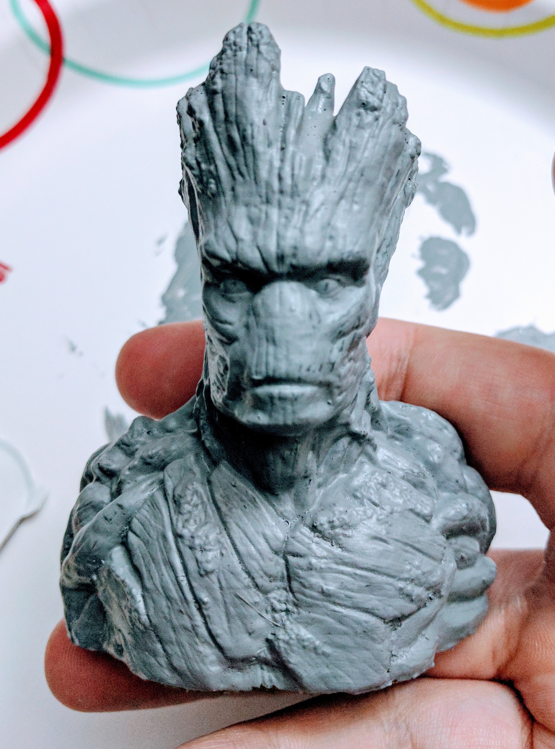

The same Groot from the other day, printed on my YHD-101 with FunToDo unpigmented Industrial Blend at 6s/layer and 0.05mm layers, now with gray gesso primer so you can see all the surface detail.
Later tests show this is a little long for layer times, but even with some overcure it still looks really good.

@Alex_Krause ​ I think it was about three and a half hours, but I’m not sure. I started it running at lunch and it was done by the time I got home from work.
@Jocelyn_Da_Prato ​ You’re misreading it a little, the resin I used was FunToDo’s Industrial Blend and I used it plain, so without pigment. The print was done with 6 second exposures on each layer, and each layer was 0.05mm in height.
