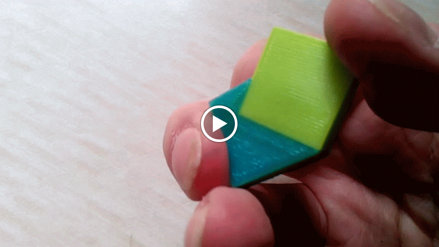

Originally shared by Steve Wood (Gyrobot) Green Filaflex and Blue Pla printed through an
Green Filaflex and Blue Pla printed through an E3D Cyclops hot end using my Dual Direct Drive Micro Extruder.
A little bit of bleed from the Filaflex but a tweak to the retraction settings should solve this.
More info on my make here : http://www.thingiverse.com/make:140726
@Sanjay_Mortimer1 @Joshua_Rowley
How much stress can these handle before the materials separate? Will future slicers need to make internal structures to help mechanically keep prints like this together longer?
@David_Grossman In Cura you can specify the overlap required between the multiple STLs that make up the different zones, effectively melt welding the different zones together, making a strong bond.
