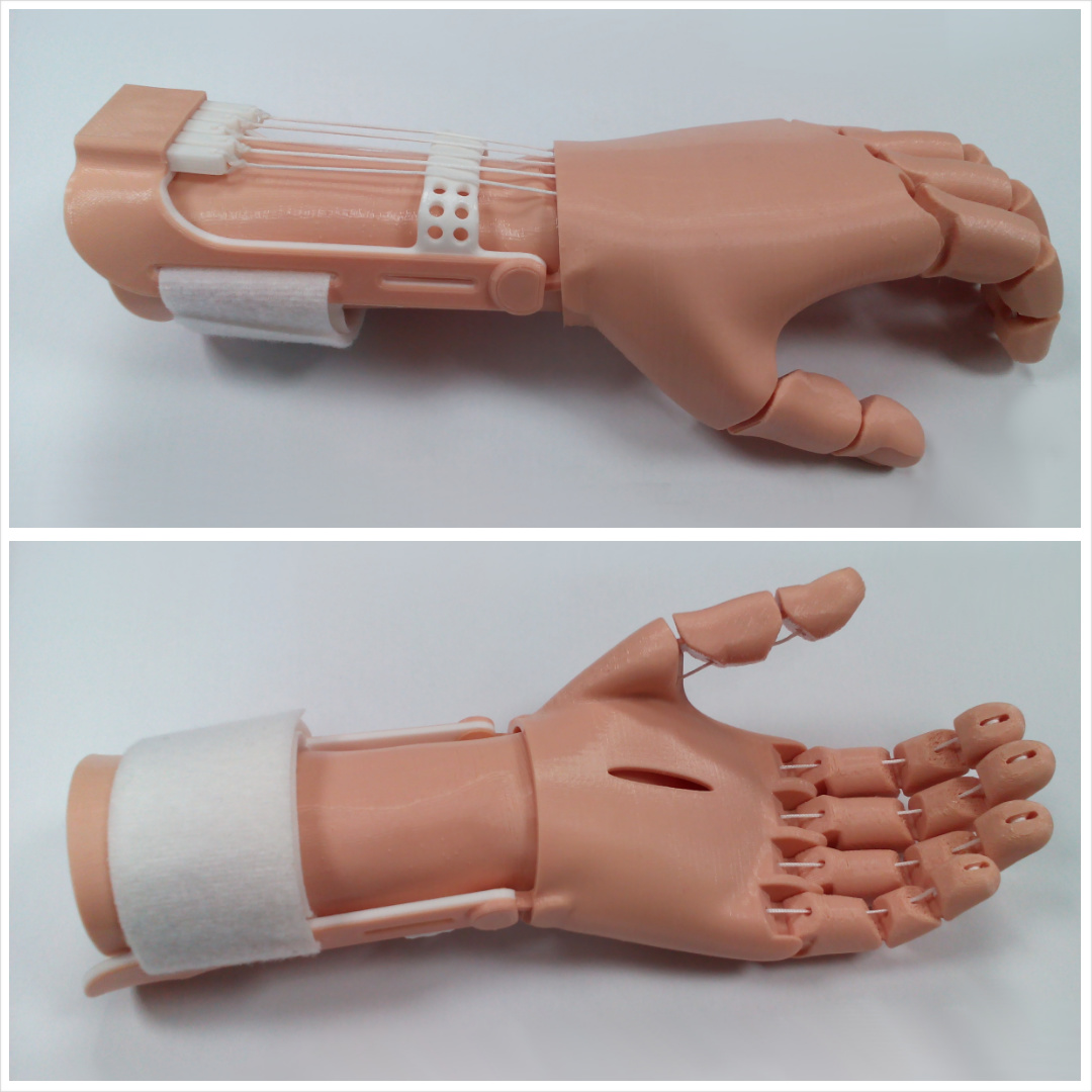

Originally shared by Steve Wood (Gyrobot) My most advanced Flexy-Hand to date.
Optimised to be printed with flexible filaments. This version was printed with Skin I Filaflex, Skin II also available.
Key Features :
  • Thermoformed Gauntlet, dual material, lower layers PLA, upper layers Filaflex, great strength.
  • Palm socket integral to hand. Can also be filled with mouldable medium, eg, Oogoo, Sugru, Silicone, Latex or foam etc.
  • Each finger and thumb printed in one piece. Using CraftWare customisable supports.
  • Silent articulation.
  • Recipient’s scanned limb printed with internal “bone” and wrist articulation. Using variable density “Modifier Meshes” in Slic3r.
Video here : http://youtu.be/dEQs-HXZj60
Download from Thingiverse : http://www.thingiverse.com/thing:640384
