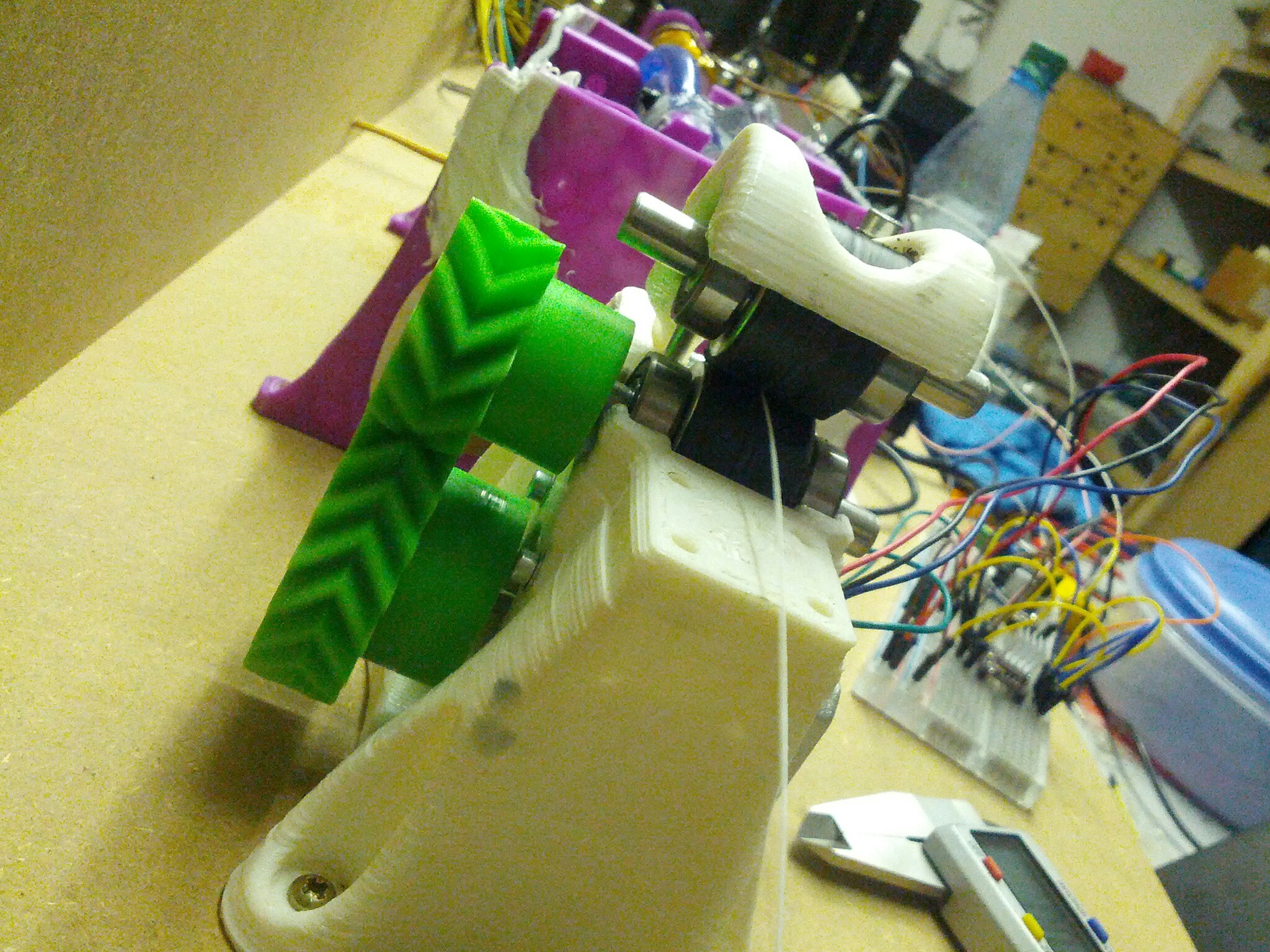

Originally shared by Thomas Sanladerer As it turns out,
As it turns out, i can make any size filament from 3.1 to 0.5mm with the 3.2mm nozzle! Even without the optical measurement and feedback loop in place, the diameter is already pretty consistent - i’m getting +/- 2% on the cross-sectional area when everything’s running smoothly. And as long as i get a bubble-free stretch, which mean that i’ll have to keep my pellets in the dryer longer than i anticipated.

Ok, let’s answer some comments * cracks knuckles *.
@Shachar_Weis The whole extruder is 100% designed and built by me (ok well, maybe got inspired on using an auger bit by Layman’s extruders). Every part was either milled, turned, printed or soldered right in that workshop, except, obviously, for bearings, motors and such.

This is excellent work! I was thinking about making a puller and small water bath for my Filastruder since the coild on the floor method is a bit archaic.
The only constructive criticism I have to offer is related to the dryer. A good industrial dryer uses hot air AND desiccant. If your ambient air has low humidity then it’s not a big deal. However, blowing hot air over plastic can actually increase the water content if the air carries enough humidity. This problem is often seen when Asian companies injection mold parts. Many times they do not have dew point controlled dryers with desiccant. The ambient air in such facilities is often highly humid. Therefore, when they “dry” the pellets they are actually increasing the water content. Not only does this lead to surface defects, but in some plastics this can actually lead to hydrolytic degradation of the polymers when the material is heated in the barrel.
@Ben_Malcheski thanks for the advice - i have a dehumidifier sitting around since my basement’s air is generally way too moist. The idea is to make another air-tight box that will house the dehumidifier and the dryer box so that the dryer is already fed with dry air.
