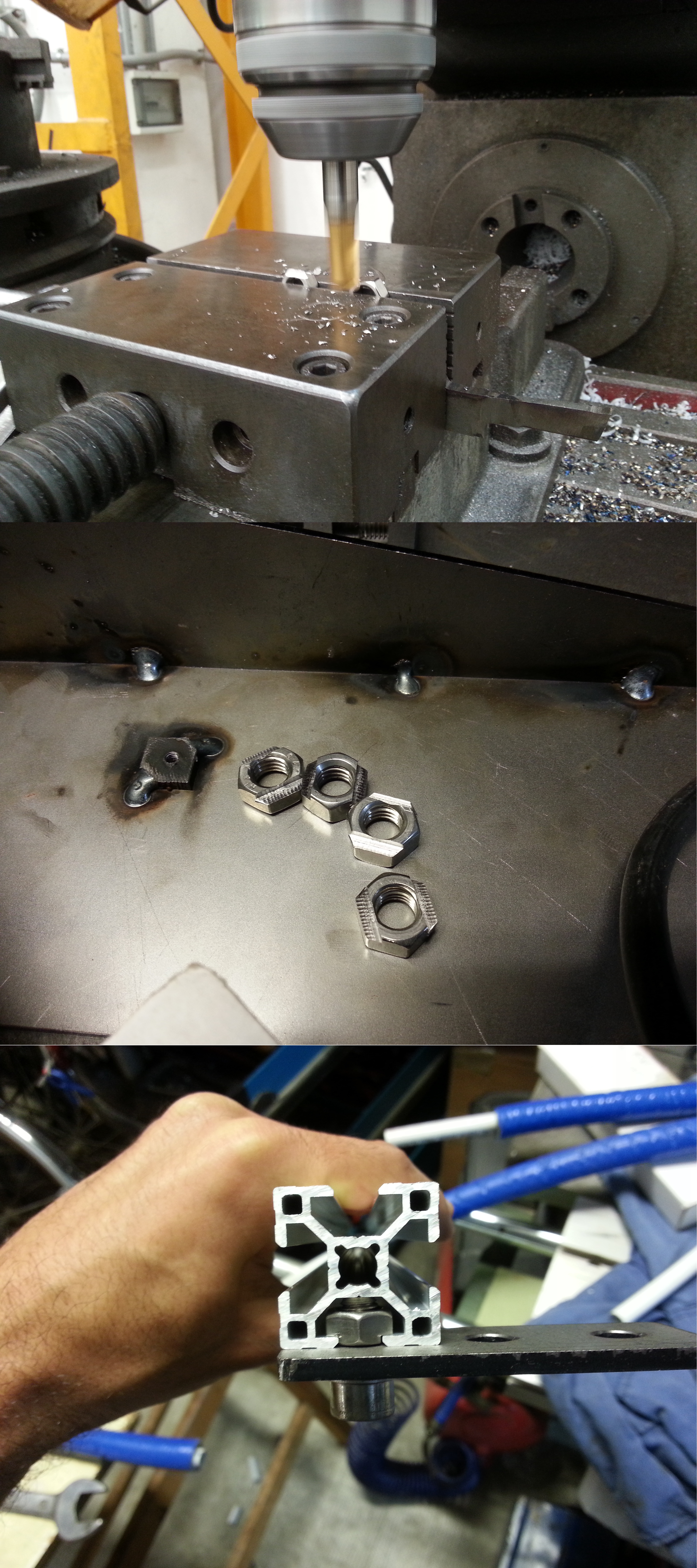

Originally shared by Walter White DIY t-slot nuts.
DIY t-slot nuts.
That turned out nice.
If you want use a printed nuts, my suggestion is to print a nut with a smooth hole, that will be drilled and tapped.

For me the way to make the slot nuts is to just put two on the end of a spare bolt to jam together, then take pliers and hold the outermost nut against a grinder. Works easiest starting with a square nut.
If you’ve got access to a manual mill like this, then I don’t see the attraction of a plastic nut. If the nut fits the slot, then a plastic nut retainer for metal nuts might be OK.

I don’t see how running a mill is reinventing the wheel anyway. It looks like those nuts wouldn’t fit the slot as-is without some amount of touch-up or using thinner nuts. This results in simple & elegant parts, and certainly much superior to plastic threads except where you don’t need the strength, but it seems the strength is generally needed for at least half the nuts.

@Mark_Rehorst or you could use a jam not placed over a 3d printed insert that has the t slot grooves on it.
It looks pretty quick & easy to do a lot of them if you have access to a mill. Personally, I bought the regular t-nuts in a big package, but I do like the results I see here. I paid Misumi like $35 for 100 M5 stainless t-nuts for 20mm extrusions. This extrusion might be 1" or 30mm, so right the nuts would probably be even more expensive.
The question is that i love the diy, but in my case, the M8 t-slot nuts for a 30x30 alu profile with 8mm cave don’t exist in Italy, and if exist, cost about 0.5€ each: too much.
