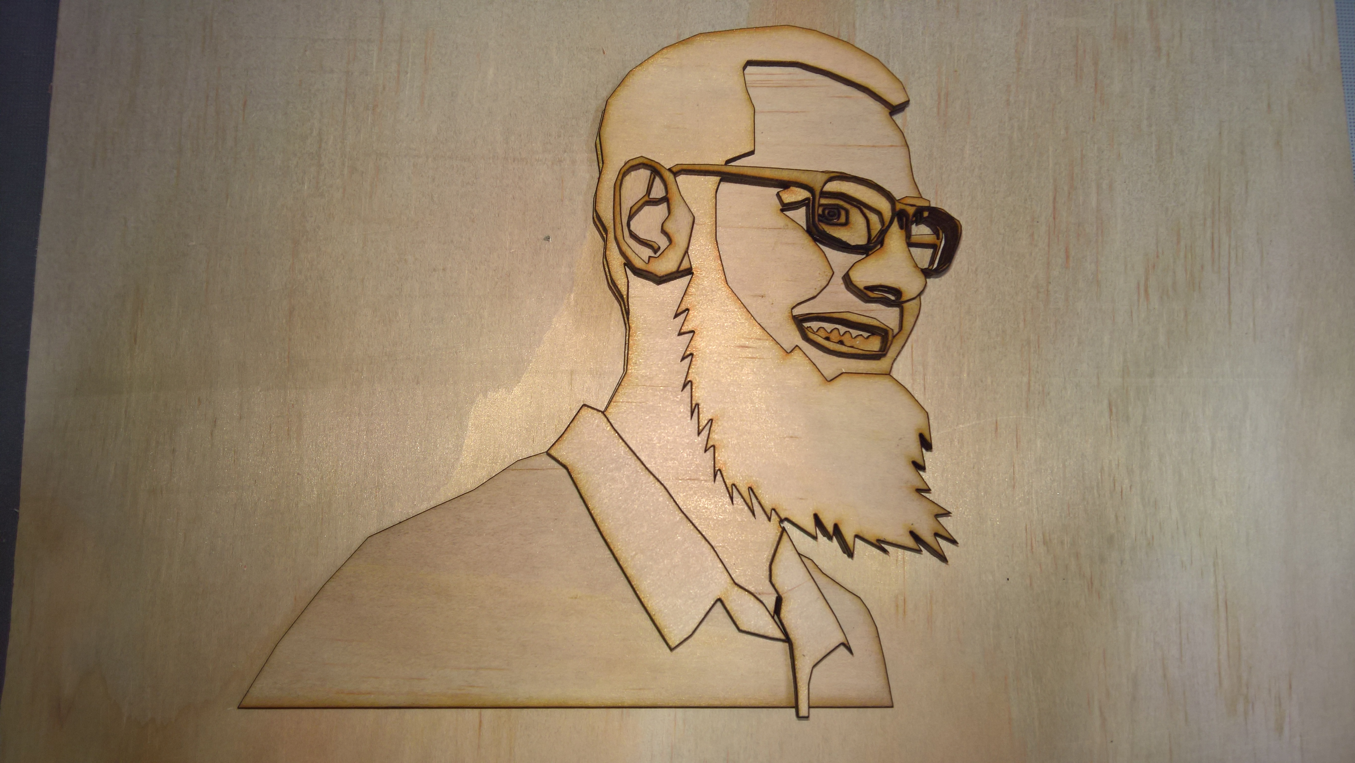

So, I had a go at the multilayer wood art. I used a reference photograph of myself to manually draw up all the levels of the image. 5 layers in total.
I’m pretty happy with the overall result. 1 pass @ 10mA @ 12mm/s on 3mm plywood.
Not glued together, but just positioned in place. Took a while as I kept bumping things because they weren’t glued.
Some of the parts were too small to be usable (e.g. I did have eyelids in the file cut out, but they turned out <1mm in width, so almost impossible to position).
@Scott_Thorne @I_Laser Here we go, first attempt.
@Yuusuf_Sallahuddin_Y …that turned out awesome…now I want to get home to my engraver…I’m having withdrawals…lol…great job.

Nice work @Yuusuf_Sallahuddin_Y ! Looks very cool, personalised profiles, you might be able to corner the market! :wink:
@I_Laser Well, I could have a try to corner the market at least. I still have a fair few ideas up my sleeve for things I can do using this multilayer technique.
Do you mind sharing the original pic you based this off? I assume it looks like you lol…
I think it could be a product people would like, especially if you add some personalised text too. Great 40th birthday gift etc.
@I_Laser Yeah, I will find the original pic & attach it in the same album folder. I think you’re onto something with some kind of personalised text too for special events/gifts.
