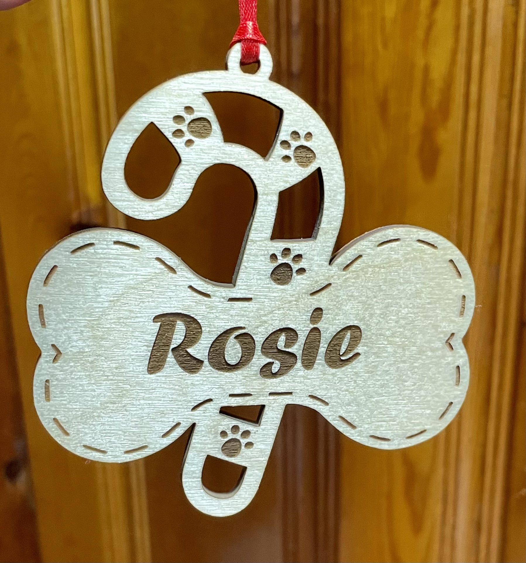

My Sister-in-law ask me if I could make them a tree ornament for their new dog. I’ve attached the svg file if anyone wants to use it.
Dog Ornament
