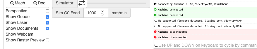

Problem description
When I try to connect the machine on USB /dev/ttyACM0, I expect to connect, but instead the “No supported firmware detected” happens.
This problem is new, as I’m a brand new CNC and laser web user.

You might have a incompatible firmware, as the error message sais. Check with a terminal program what you get from this COM-port. If the firmware reports Grbl v1.1f (or higher) then you can try to activate “reset on connect”. To do that, you must edit config.js (on the raspi) and change the line:
config.resetOnConnect = process.env.RESET_ON_CONNECT || 0;
to:
config.resetOnConnect = process.env.RESET_ON_CONNECT || 1;
Thx a lot for your answer, I can now connect to my machine.
