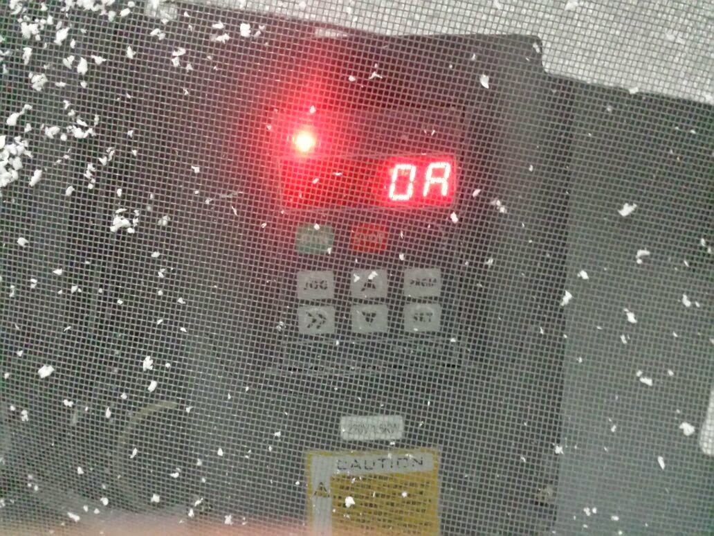

Our VFD is coughing from time to time. The spindle just stops spinning and this is the display status when that happens. Any idea of why is this or how to fix it? Anyone has experienced a similar problem with 1.5kw Huanyang VFD? Thanks in advance guys.
I can only guess that it is some form of overload. The user manual seemed rather less than useful in this case.
@Kyle_Kerr exactly, manual was helpless here. Power cycle the VFD and you are back in business for days or weeks. No overheating seems to be happening.

Hi Miguel, i´ve worked with a lot of inverters but never saw one with such a bad configuration file and poor manual. So, become curious with this chinese “wonder”. OA usually means overload in good inverters. The following manual seems an approach to that: http://www.jinlantrade.com/ebay/invertermanual.pdf
In the last pages there are some errors mentioned and the E.OA.A seems to be your problema even with so many letters.

@Jose_Lobo We have a 1CV teknomotor spindle running 10 hours/day milling foam. It did not occurr to me that these four letter messages could be similar to mine (you are right that OA might well represent one of the several overload conditions). On a good month we may have only one problem and then one day it fails twice. I was about to replace the VFD but once of the troubleshooting suggests motor isolation failure, which kind of rings a bell to me. So I think I am going to replace the spindle and see if this goes away. Thanks a lot for the suggestion.
