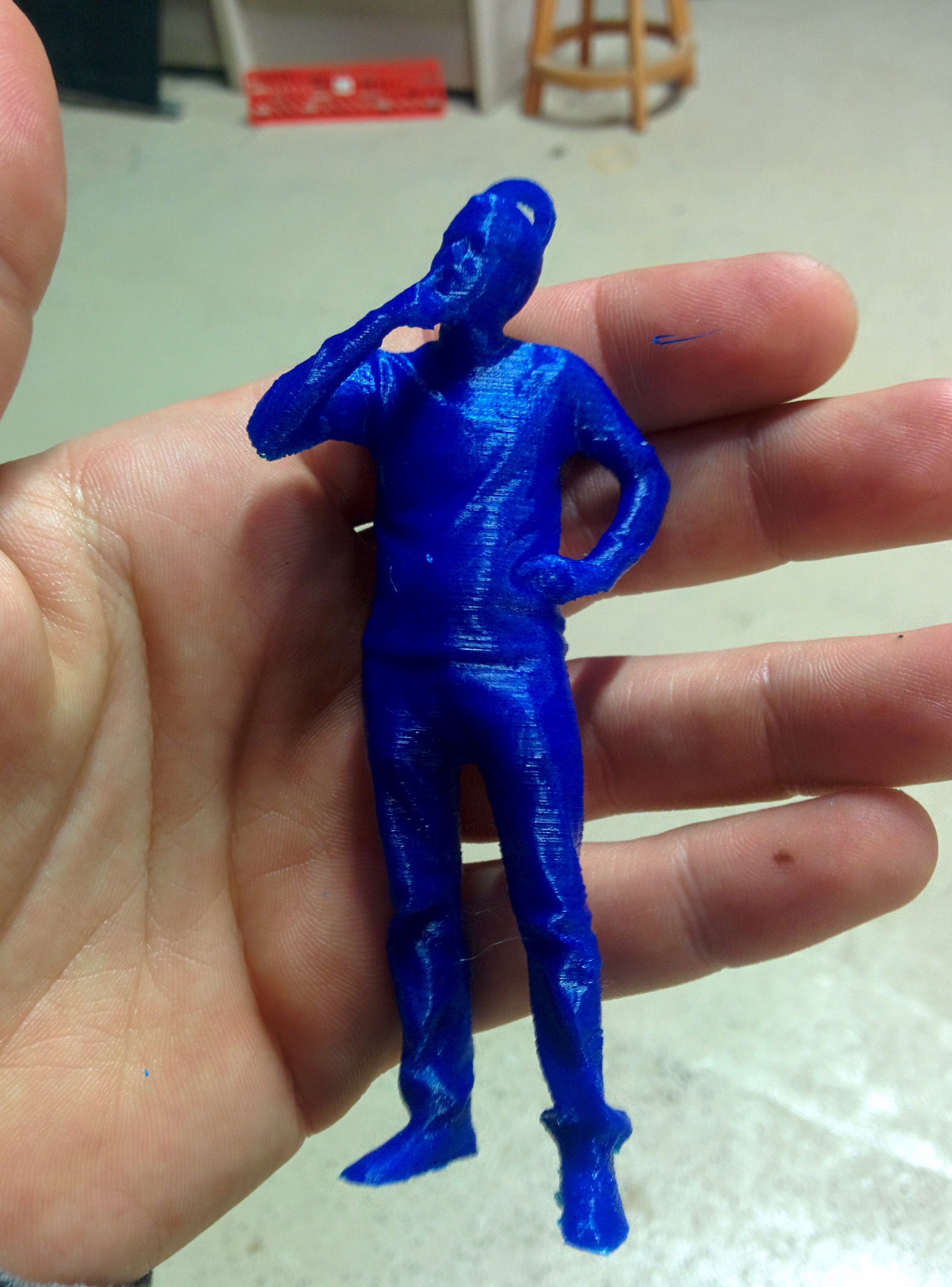

Our Vortex Artec Studio + Kinect scanner has been doing some killer work over
Our Vortex Artec Studio + Kinect scanner has been doing some killer work over the last few months. Here are a few of the prints so far.
All 3D files available here: http://www.thingiverse.com/thing:609374
Printed on my Bukobots. .15mm layer height. 150mm/sec throughout except exterior shell, which is 80mm/sec
What slicer? And is it hard to set up scanning with the connect?
This is slic3r. Still have issues printing layers thicker than .2mm with this setting but I use Cura for quick prints.
Is the layer problem because of your nozzle size or just the accuracy of the scan itself?
Nozzle size: .35. Should accomplish .3mm layers with slic3r, but I’ve found prints over an inch start to fall more and more per layer added.
