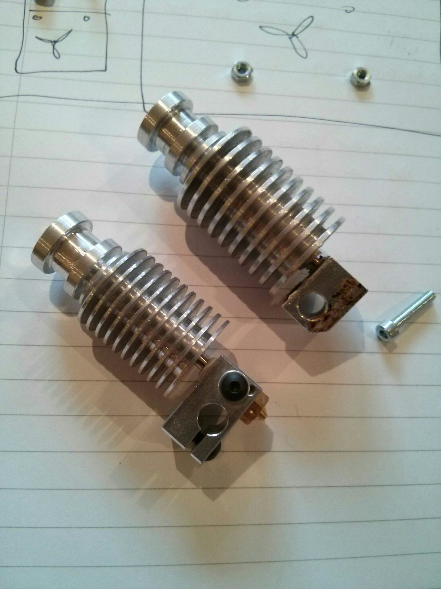

Out with the old. In with the new. Hopefully this should fixed everything…
I’m not expecting to have a working printer at the end of this but we’ll see.

I have a v6, is the one on the right a v5?
I have no idea
Had a lot of issues with extruding and heat creep so the manufacturer has provided a replacement head arrangement.
Your using a fan on them right? Those have to have a fan on the heat sink
Turned out the new cage requires a larger fan. Waiting for that to arrive before we’ll know.
