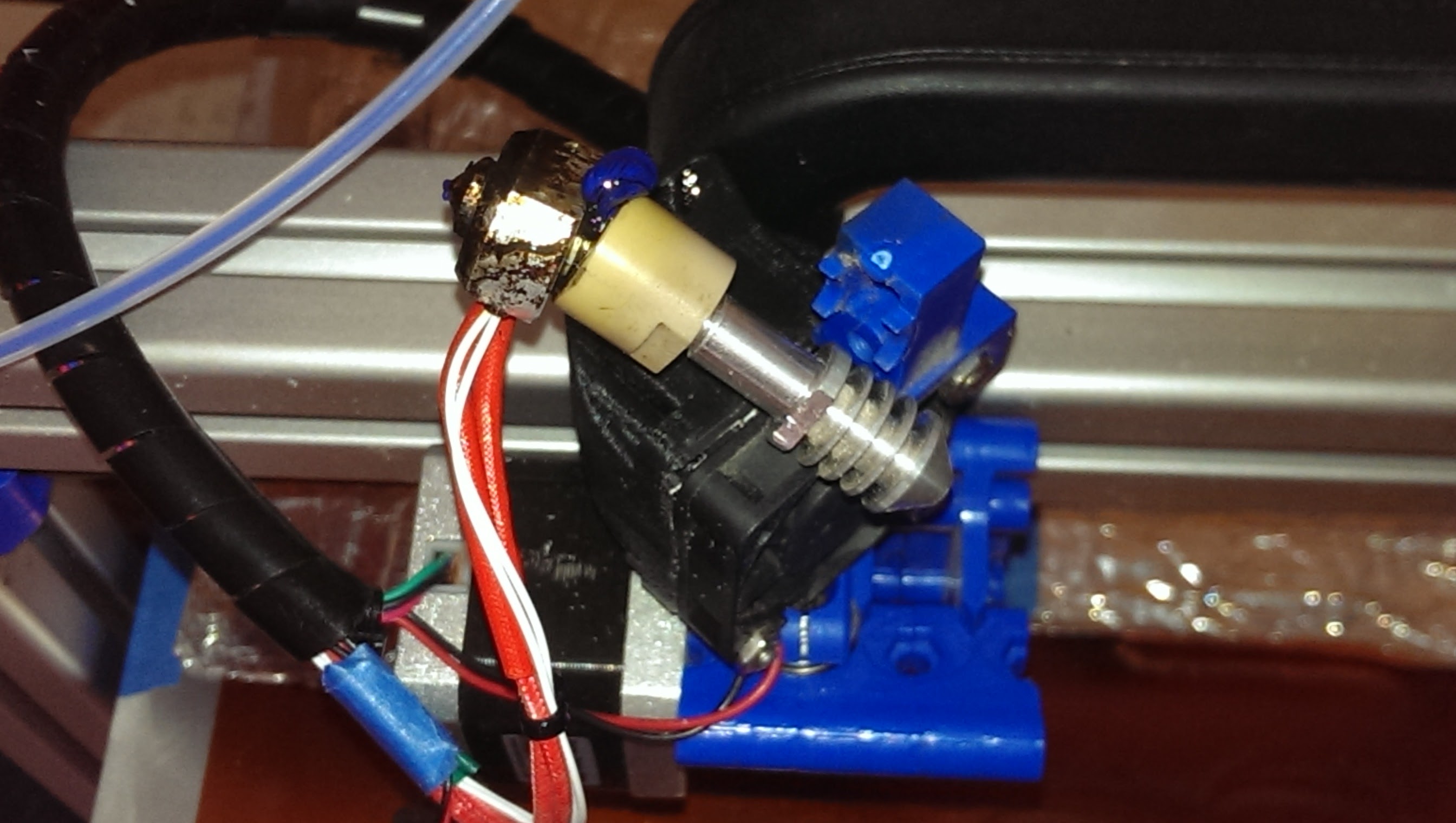

Overheated PEEK isolator on the (POS) Felix 3.0 extruder.
Overheated PEEK isolator on the (POS) Felix 3.0 extruder. All my excuses are gone now; next week I get to finish my upgrade to the E3D Chimera.
What caused the meltdown?
I don’t think it’s designed with printing ABS in mind. I’d say the thermal design of the Felix extruder is deficient, but it doesn’t seem that there was much if any actual thermal engineering done on it.
I’m not familiar with that hot end, looks kind of bad at a glance. Does it have a PTFE liner? I’m guessing the PEEK threads got too weak due to elevated temp to contain melt pool pressure, and simply gave out.
Yep that’s it. No idea on the PTFE liner.
Wow, that design just looks questionable right off the bat. It’s a good thing it can be replaced with something that’s known to work well, though the mount has to be changed. It looks like as if they rejected every other design, including the mount, because it wasn’t invented by them.
