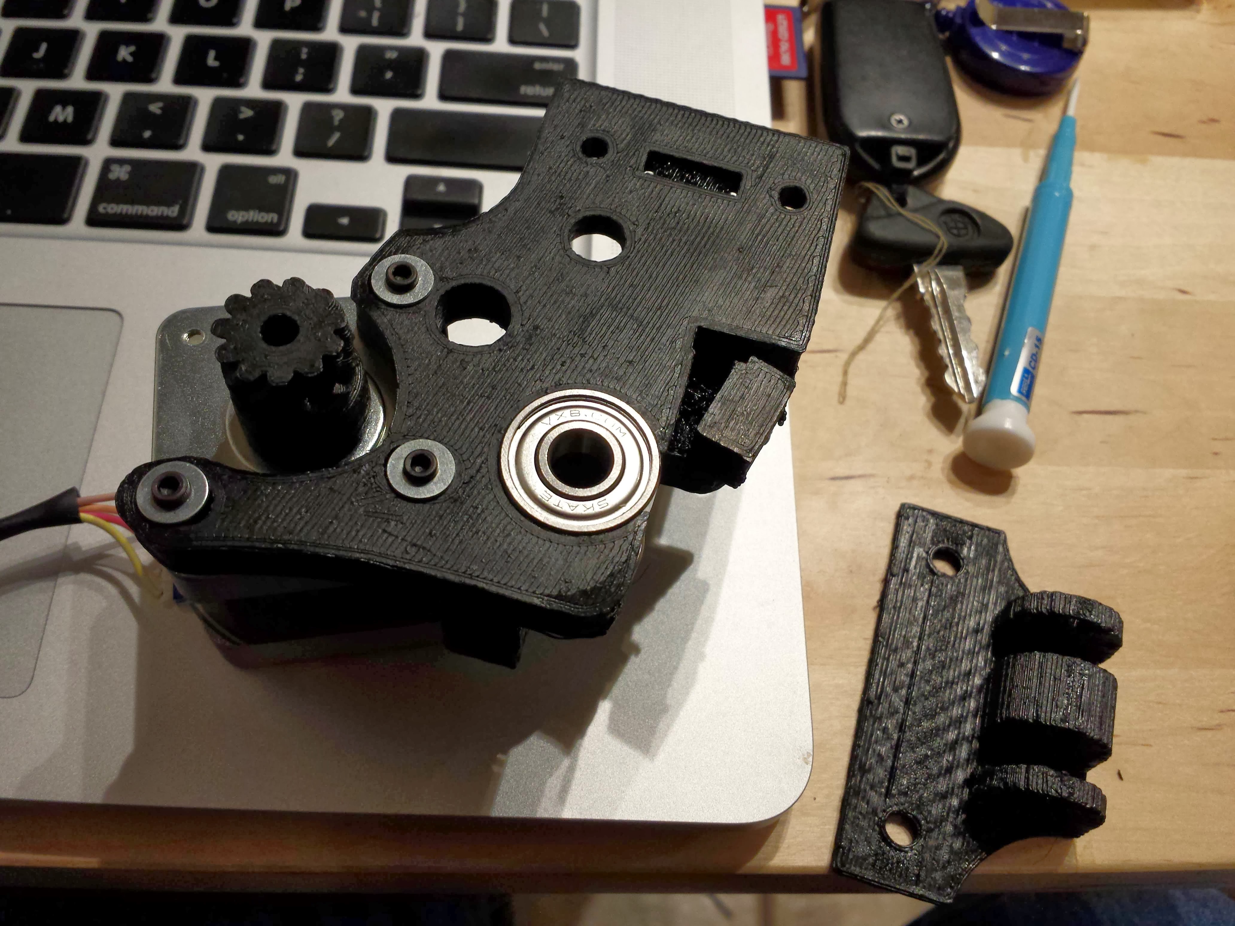

Looking at the following picture of the Bowden extruder…that diagonal piece at the 3 o’clock position? I’m to remove that to finish assembly, right? It’s the only way I can see to complete the tensioner…
Ah well, off to hob a bolt!
And where do folks find springs to tension things?
Yes, you need to remove that. I use springs from pens.
I buy springs from a surplus store, Amazon or home depot when in a hurry, or from aliexpress, when I have time to wait for the show boat… from China
I found springs at a local hardware store, I think it’s an Ace affilitated one. I could never find the right size at Home Depot or Lowe’s.
I use a couple of chunks of silicone rubber cut from an Ikea trivet between two washers. Works ok, but it makes it too easy to over tighten the bolts. I find that 1.75mm bunches up between the bolt and Bowden if it’s too tight, vs. 3mm which needs more force.
I’ll go hit the hardware store tomorrow. I ‘made’ my own hobbed bolt by chucking it in the lathe, chucking a tap in the drill and rubbing one against the other for a bit. Holy Crap that worked GREAT…unless it ends up wearing (which is doubtful…PLA is relatively soft). It’s not hobbed, per sé, i’d have had to somehow synchronize the two…it’s more a bunch of spikes in the threads…anyway, holding the two pieces together, there’s a LOT of friction available to grab the plastic.
