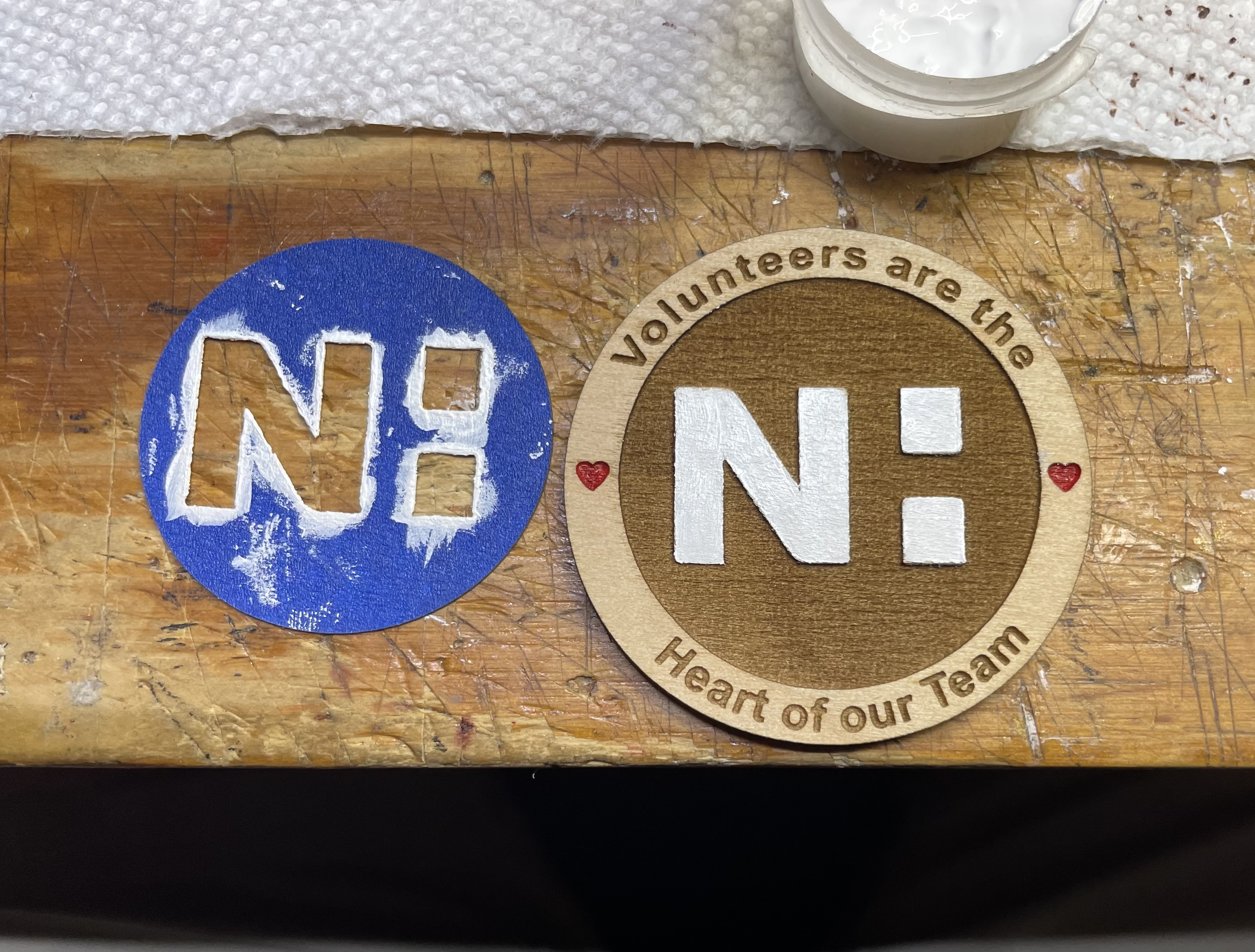

A few years ago (5!) I was contracted to make some Volunteer appreciation buttons for the hospital where my wife works.
This past year the hospital was acquired by the large hospital system Novant Health. So they wanted to make new buttons this year for Volunteer Appreciation Week with the new logo. But they wanted 300 buttons this time. :scream: With white paint it was going to take 2 coats so I had to come up with a way to make the painting easier so it wouldn’t drive me crazy.

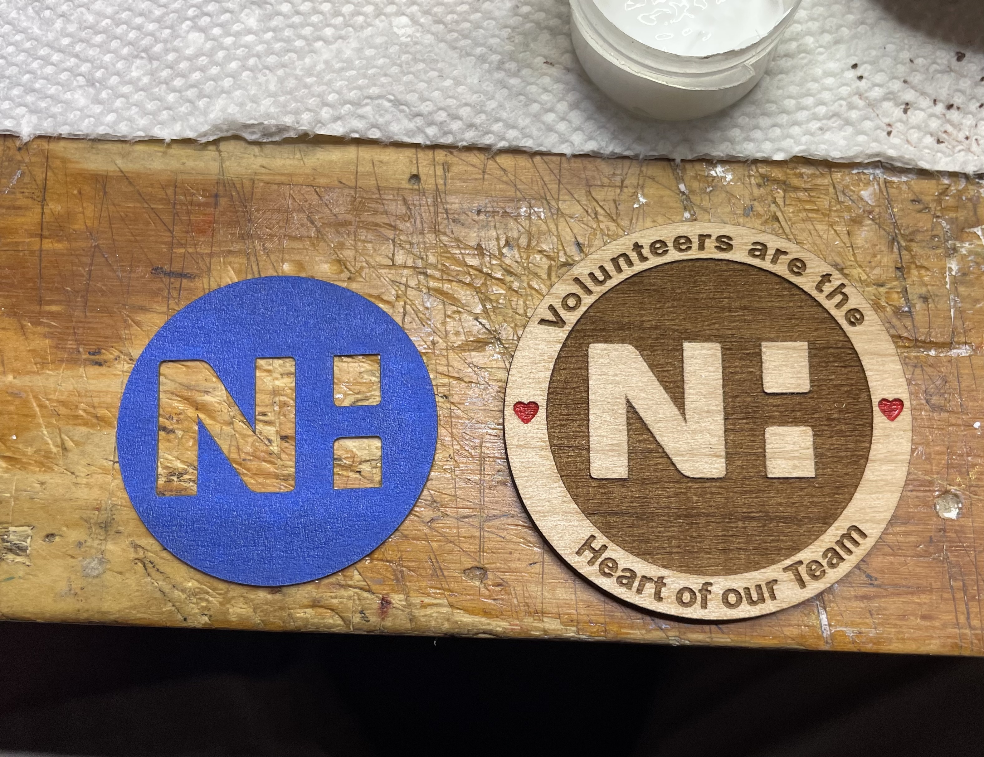

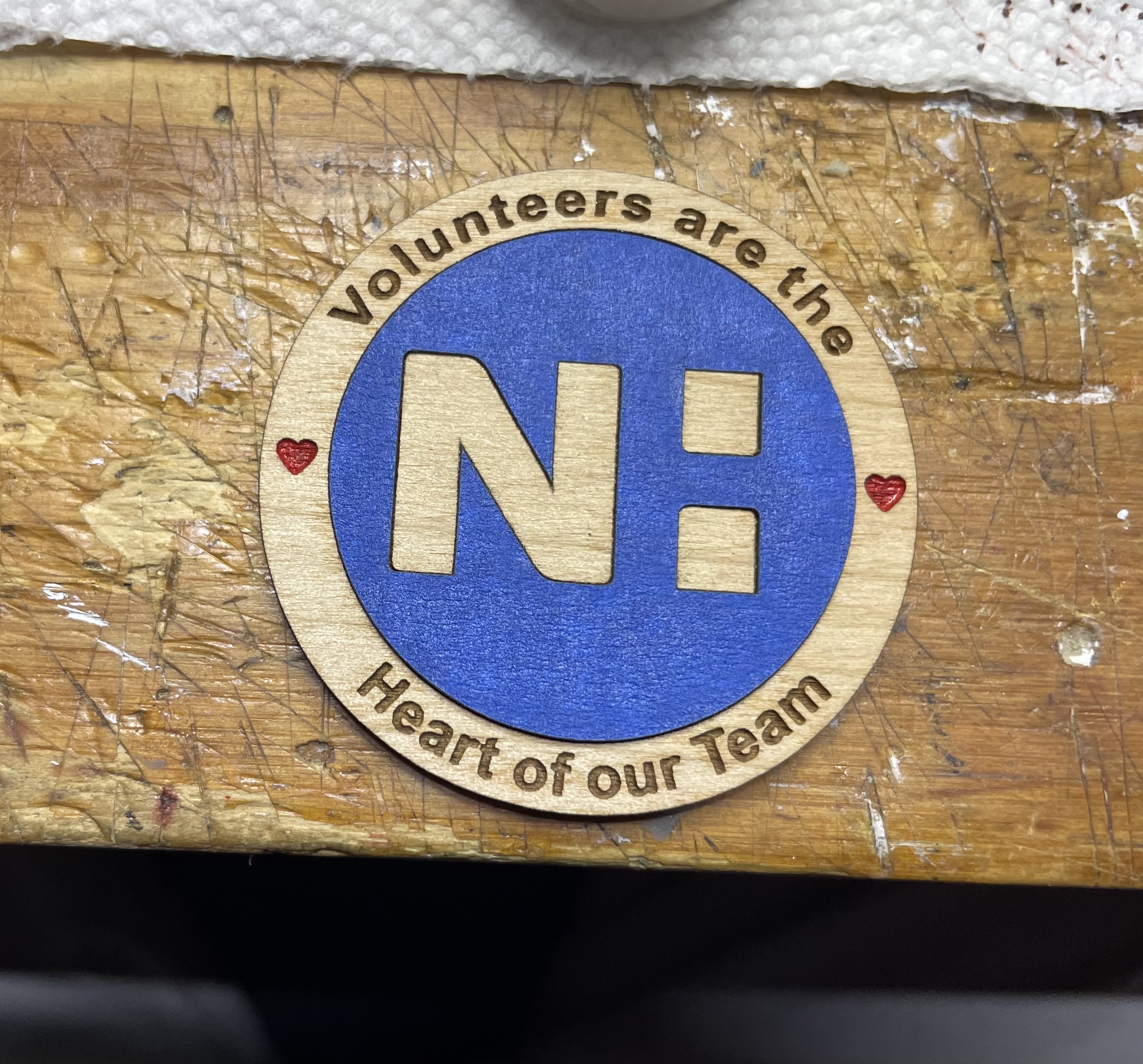

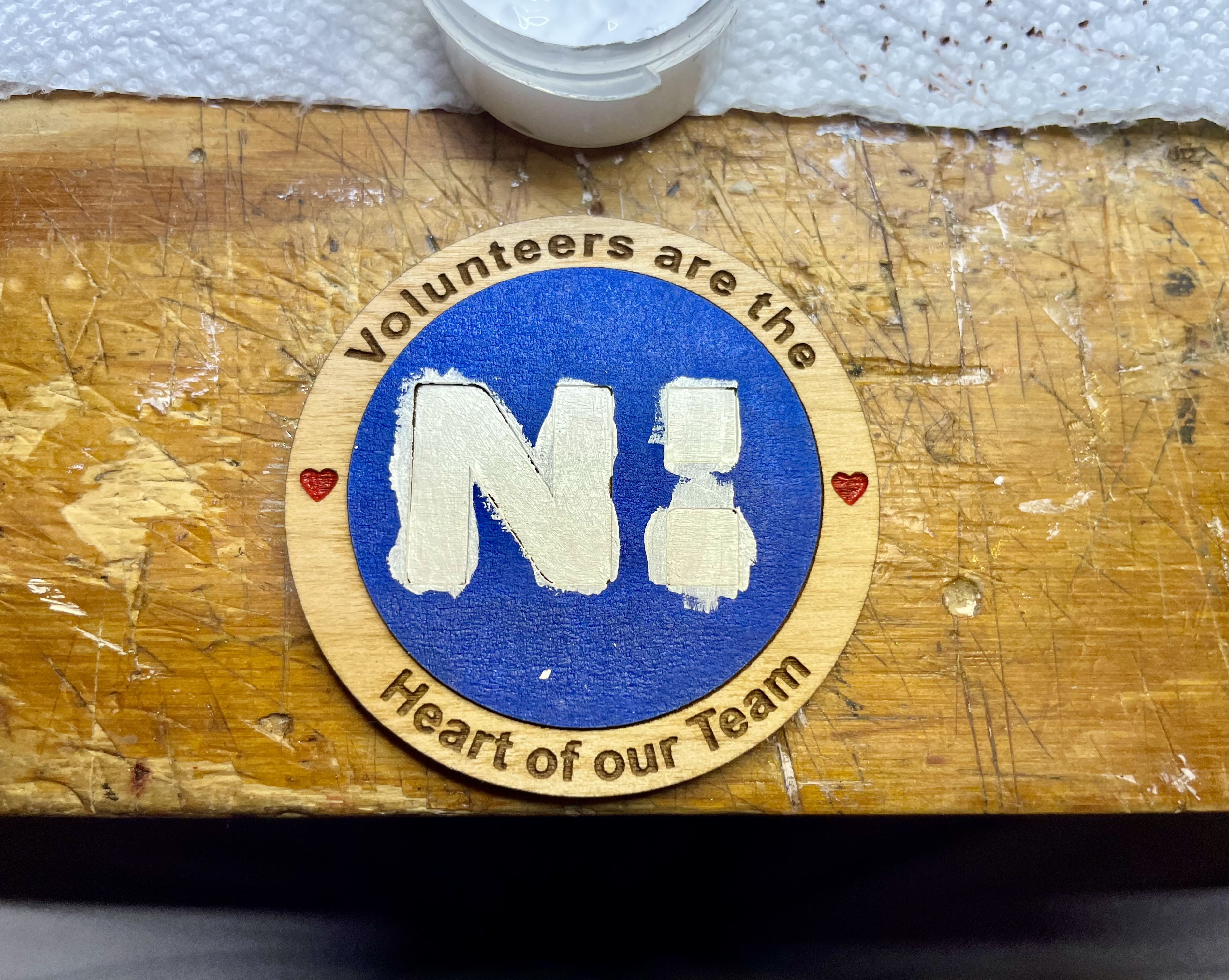

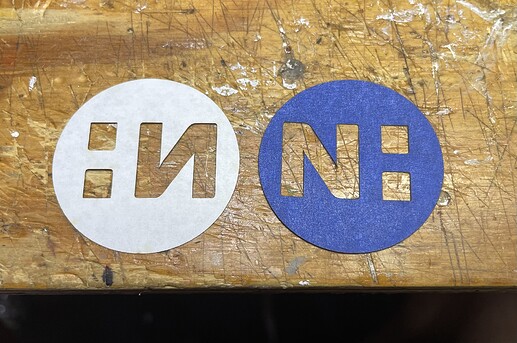

Decided to make some laser cut, what I call, sub masks. Applied wide blue painters tape to printer paper and cut out tight fitting masks. Quick and easy so I used them as single use.
Made sure the engraving was deep enough to accommodate the mask .
Worked out pretty well. The small amount of bleed I would get from time to time was easy to touch up with an ultra fine point brown sharpie marker.

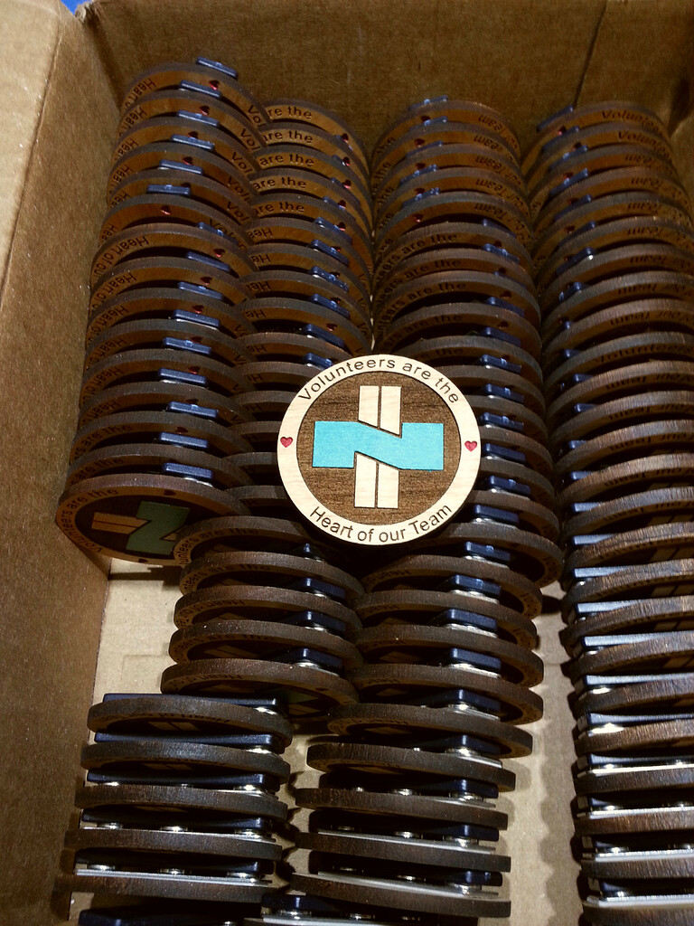

Did you then glue 300 pins on the back of those?
No they were almost all self adhesive magnetic backs So that part went fairly fast with a little alignment jig I made. Did glue a few with pin backs for people with pace makers.
