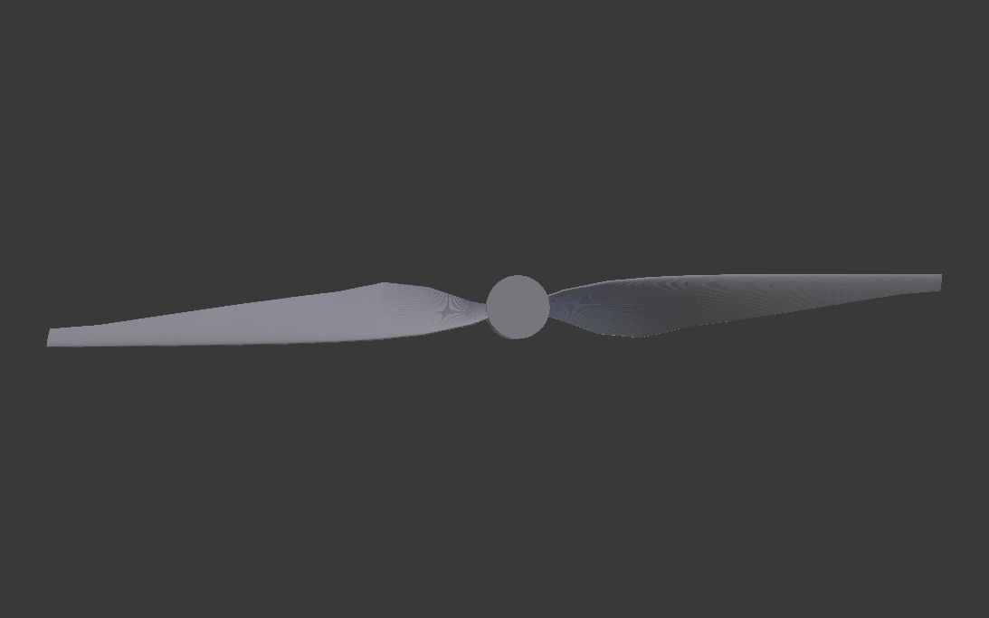

Parametrically designed 3D printed propellers anyone?  In the picture is a 9x6 prop.  I'm
Parametrically designed 3D printed propellers anyone? In the picture is a 9x6 prop. I’m travelling right now and have some downtime so I decided to work on this.
This is an extension of the Turbomachinery Library I wrote a while back. It’s coded in Python and uses the Blender API. Currently limited to NACA4 airfoils. WIP.

I’m going to make a separate GUI for the propeller and the ducted fan soon. Right now it’s all on the same panel. The propeller section is at the bottom of the panel.
