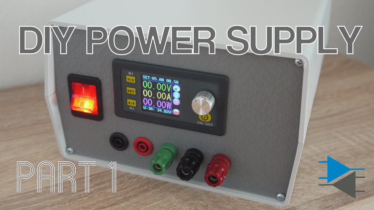

Part 1 of a new project: DIY Lab Power supply with 3D-printed brackets,
Part 1 of a new project: DIY Lab Power supply with 3D-printed brackets, front- and back panel! Using the Hilbert-Curve Preset on slicer really makes for an interresting almost marble-like surface effect. Definitely going to use it more often!
Check out the video of the making here:
I had never heard of this little module; I’m actually gonna grab one now – interesting stuff on the hilbertcurve bottom layer too.
@ThantiK there is open source firmware available for it (https://johan.kanflo.com/opendps-design/) which I will flash and install an ESP8266 module for wifi connectivity. I’ll post part 2 when it’s done editing :slight_smile:
