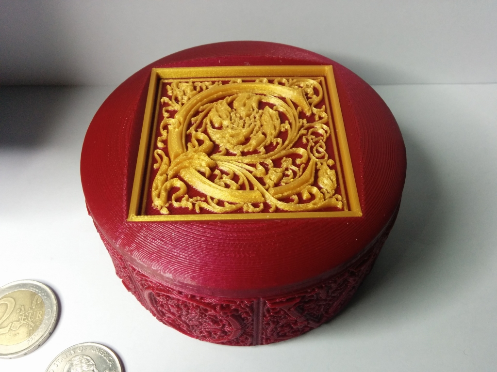

Particularly pleased with the way this this dual colour letter insert came out.
Particularly pleased with the way this this dual colour letter insert came out. Printed at 0.2 mm layer height, paused the print at 1 mm (start of layer 5) and change the filament.
