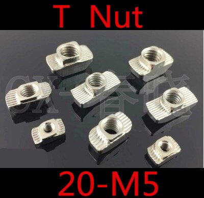

I purchased ~20 extra T-nuts as I thought they might be handy as ‘tie-down’ points for extra “stuff”
In addition to the T-nuts shown to mount bearing holders, spool holder, etc., can anyone recommend placement for additional T-nuts?

I did my best to lay stuff out on the aluminum build plate. A relatively flat counter top should work just as well. Definitely get post assembly T-nuts, you will forget some.

Forgot about the existence of post-assembly T-nuts… Thanks for the link.
