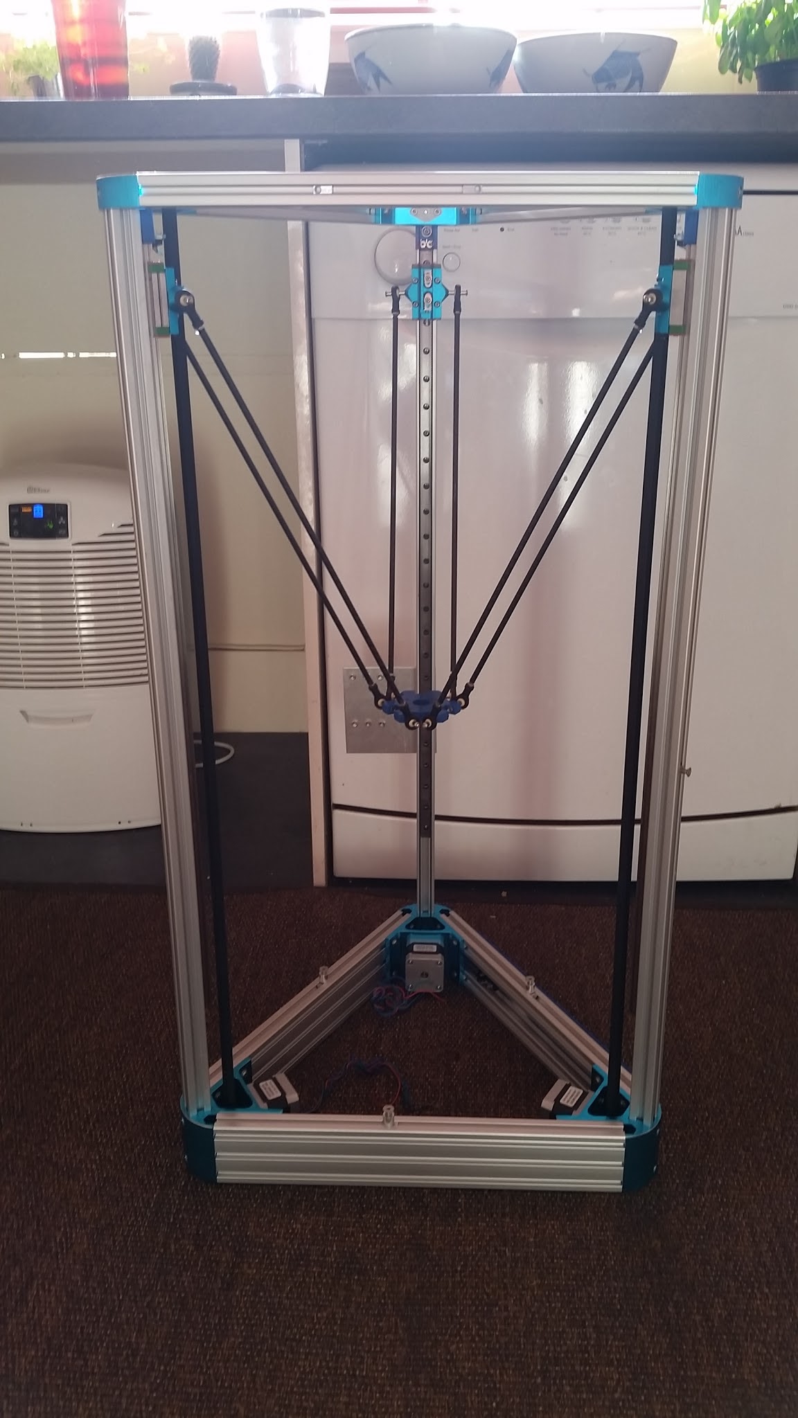

Parts have started arriving for my Kossel build,
Parts have started arriving for my Kossel build, going to be a bigger than a mini but so far I’ve got the following:
Duet 0.6 controller
IR probe
PanelDue controller plus a 5 inch touch screen
E3D V6 @ 24v
E3D Titan extruder
0.9° stepper motors
Linear rails and bearings
Aluminium corners & carriages
Heat pad 400w 220v
Hoping to be able to get a fast print speed.
She looks hot my friend.
Looks gorgeous and is tempting me to build one myself. Where did you get your linear rails and blocks from?

From Robotdigg
