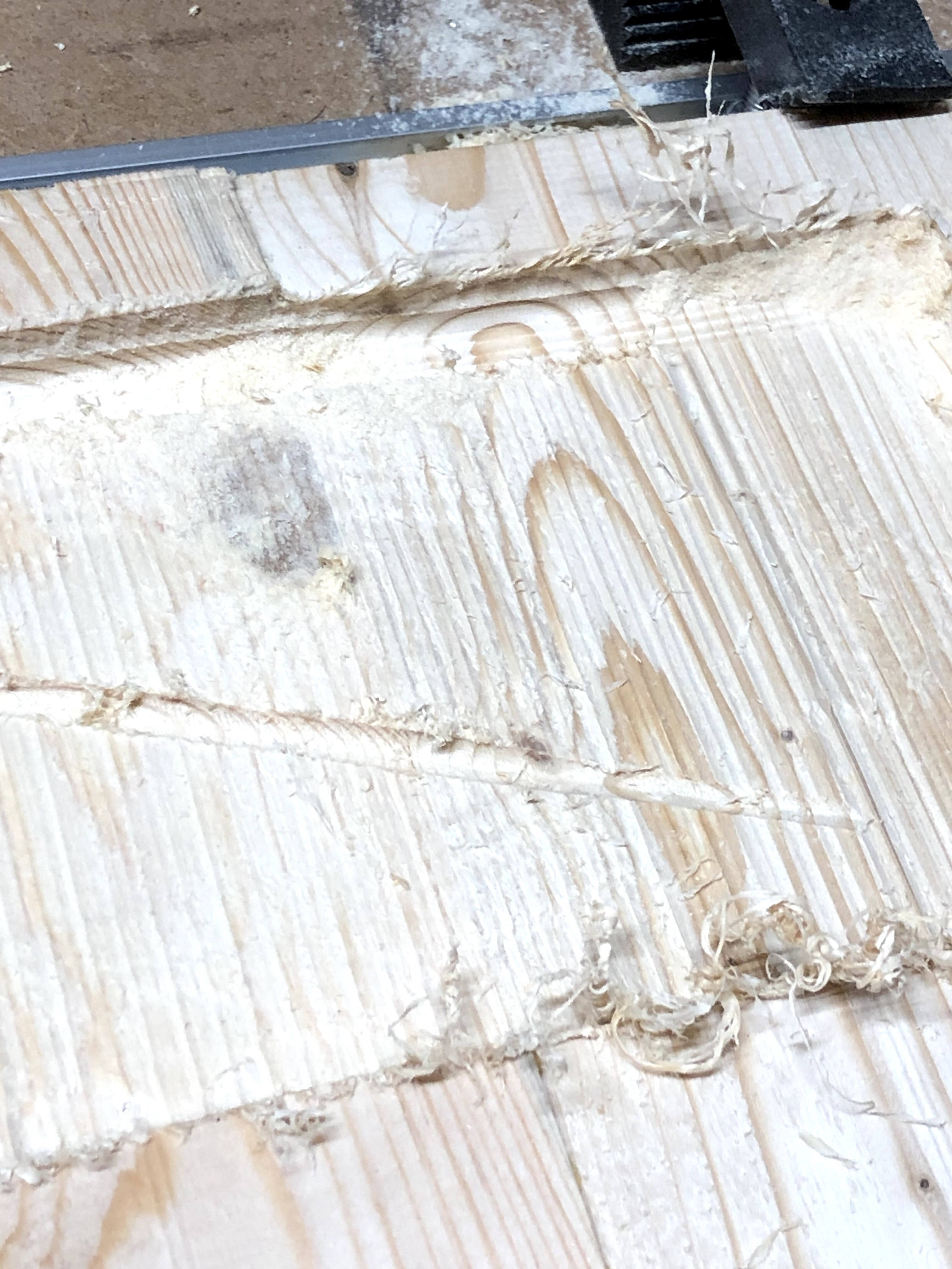

@Paul_Frederick Can you see how my Z axis occasionally goes lower than it should? What would cause that? Mechanical or controller issue?
I bet mechanical. Controllers, if they drift, don’t usually drift back unless they’re servos. They drift and then stay there (or are overdriven and lose steps.) I’d suspect varying loads resulting in machine deformation. You could put a dial indicator on the spindle and do a bunch of z cuts at a fixed depth through different materials and see if you can catch it moving.
@John_Bump Thanks John. That helps. And that sounds a little like what it did (drift). Though it did stay down to its lowest height each time I ran the job. But, the (drift) occurred at different places of the cut; indicating to me that it is likely a mechanical issue…

@John_Bump the downside of open loop is you never make up lost motion. Once it is gone you’re off from there on out. Or until you home again. You can check actual measured vs calculated position. Then see if there’s a discrepancy. Then to remedy that you have to drive less hard. You’ve exceeded your machine’s capabilities. Which is something open loop should never do. That’s why the big boys run servos with encoders.
Yeah, open loop is essentially a random drift process and the only question is how wide a drift you get. If you’re lucky and careful you don’t get any. I suppose with most machining strategies all you’ll get is less Z depth than you intended, since you’re always driving Z down into a load, never up into a load. But X and Y could go either way and slowly accumulate error. (Or quickly: I’ve had sudden accumulations of several MM of error when a chip welded itself solidly to a tool and the tool stopped cutting but kept trying to move.)
@Paul_Frederick Mostly it’s a climb direction (not Conventional). However, these 3D cuts do parallel cuts and go both ways. Since I changed the rotation of the spindle, today was the first time I’ve had this issue. I used the same style cut earlier this week and it didn’t happen. Your comment about bending under load is an interesting one, and I’ll check that because it’s possible, as I’ve wondered about that at times. One note about the current issue: I had just been trying some cuts on aluminum just prior to this cut and, in order to limit any likelihood of that bending, I positioned the vise just above the supporting beam under the table. Unfortunately, for the aluminum cut, I still didn’t quite have a fully sufficient work holding strategy which ruined its cut. But, I don’t know if switching from wood to aluminum for one cut had any effect on the machine.
@John_Bump So, the fact that I machined some aluminum before this cut (thus the greater load) may have caused the current (drifting) you are talking about?
No. Lost steps are from an overload during a cut, when the stepper just can’t move the bit through the workpiece. Once you rehome, for the next job (or even within a job) you get your position back. Some people rehome after every toolchange (as part of assigning the tool length and making sure it’s in the collet right) and some people even rehome after every heavy cut.
@John_Bump Got ya. After you mentioned drifting, I did a little research and I think it may be the result of a loosened pulley on my z axis. Obviously, I can’t be sure, but that makes some sense as I’ve been having issues with that pulley. The fact I put such a heavy load on it may have loosened it up.
