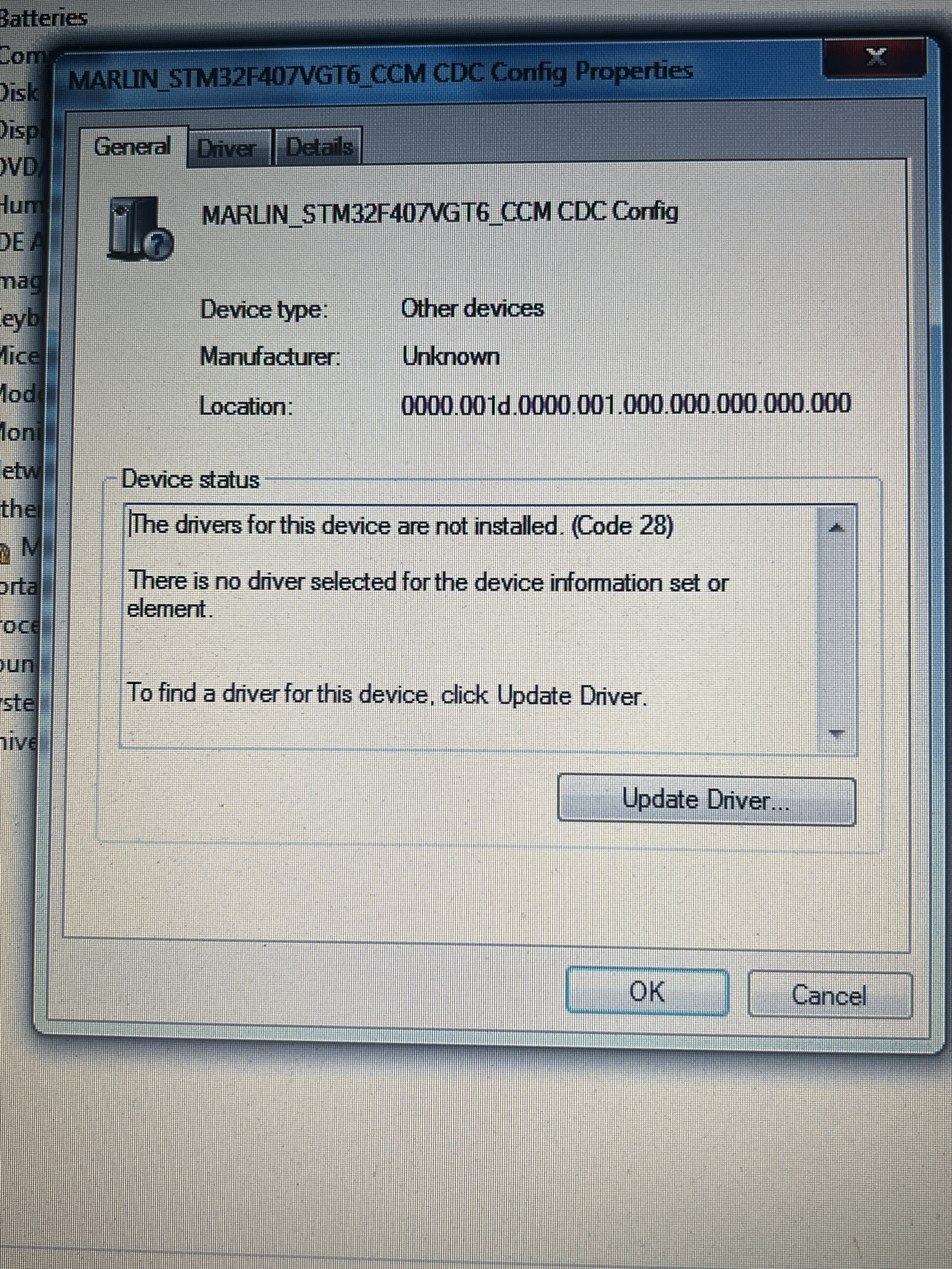

I bought an MKS Robin Nano V3.1
The motherboard does not connect to the computer. I receive this message “Marlin_STM32F407VGT6_CCM CDC Config”. How to solve this problem?
Thanks
My guess is that you’ll need to install a Windows driver to get communications working.
Thanks for the answer! The problem is that I can’t find this drive.
Estou com um problema semelhante. MKS Robin Nano V3.1 não comunica direito com o Windows 11.
I don’t run Windows but if you google for the dirver you should be able to find it. I found one here and like I said, I don’t even run Windows. From the documention for the board it says that it uses a USB interface based on the CH34x chip so this driver should fit the bill.
Eu tive este problema com o windows 7, depois que instalei o 10 ficou tudo ok.
Tente fazer um update, pois este drive deveria esta no windows 11.
I had this problem with windows 7, after I installed 10 everything was ok.
Try to do an update, because this drive should be in windows 11.
